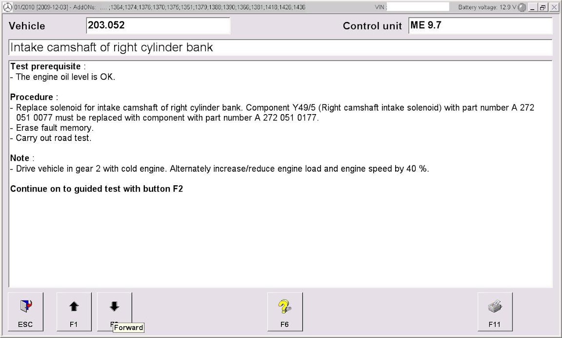

Now that I have STAR, I went to look at the code in STAR DAS, and here is what I got:
Interesting how the second screen says to NOT replace the camshaft position sensor. Also, it says to replace the solenoid, aka magnet. Looks like the part was superseded, so that makes sense. Only $15 for the part, so I just ordered one.

Replaced the magnet/solenoid about 2 weeks ago, reset via STAR, and ran the camshaft position test in STAR. So far no CEL, and surprisingly the car runs better. Guess I didn't realize that the somewhat rough idle and a touch of hesitation every once and a while were from the magnet/solenoid being faulty. Checked the part number on the other 3, and they are the same old part, so may have to change out those with the revised parts at some point. Overall a cheap and easy fix to a minor annoyance.

Just an update 3 months later and no CEL, so I am convinced the problem is fixed.
Just wanted to bump this thread as a new member blanco617 has this code as well as p0022 and p0025, which are all the fault of the camshaft solenoids that have been revised. As I suggested to him in PM, I would replace all 4 of them, as they are known problem parts.
Attached is the EPC diagram of where they are located. It is the red circled part 140: Also attached is a picture of the front of the engine cylinder heads of where the solenoids/magnets are. They are super easy to replace. Just remove the 3 bolts in each one with an E8 external torx socket, unplug the connector and replace with new.
Part can be had here at Parts.com: http://www.parts.com/oemcatalog/inde...ber=2720510177 for $14.95 ea. Part number is attached to link.
Let me know if you need anymore help. Reading this thread in it's entirety should answer all the questions.

They shouldn't be even touching the sensors. In the pics I posted above from my STAR system, it clearly says NOT to replace the sensors, just the magnets. I have replaced both, and if they say 2-2.5 hours to replace, I suggest they need to find more competant techs. Half an hour at the most to replace the magnet AND sensor.
