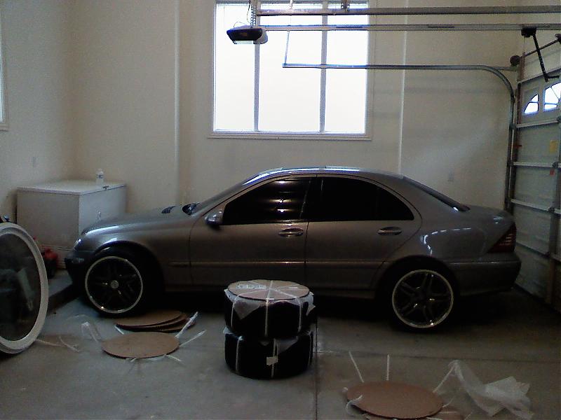

New Wheels!
I finally got my wheels in. Sorry for the bad quality pictures it was off my camera fone and it is snowing out here so I just layed them next to my car to see how they would look in my garage. I'm pretty happy I bought the bright satin finish on these wheels because it totally sets my car off. Ill update with new pics off a better camera when I put these on next week or as soon as it gets warmer out. Tell me what you guys think!
Attached Thumbnails W203/CL203 Aftermarket Wheel Thread - All you want to know-0327081711.jpg

Old Mar 27, 2008 | 06:25 PM
  #4748
kevblah's Avatar
Joined: Feb 2007
Posts: 3,840
From: MA
E90 M3
i like em! whered u get them from?
Old Mar 27, 2008 | 06:31 PM
  #4749
rlee02135's Avatar
Joined: Mar 2006
Posts: 6,665
From: Boston
2004 C32 ///AMG
looks good! ASA ST4?
