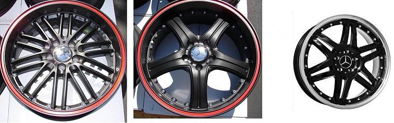

im a litte confused, what would u buy for a c230 coupe ?

I dont like the first wheel, the second wheel is okay, but I don't like the third either.
well urs (on ur coupe) are like the 3rd.. i less dual spoke thats all !! so its weird that u dont like it....

yeah i get ur point... the 3rd set is from eurotechluxury ebay store, and if im not mistaking, i saw some recommandations for that store on the aftermarket wheels thread.....
do u know it ?
what about ADR wheels ?
