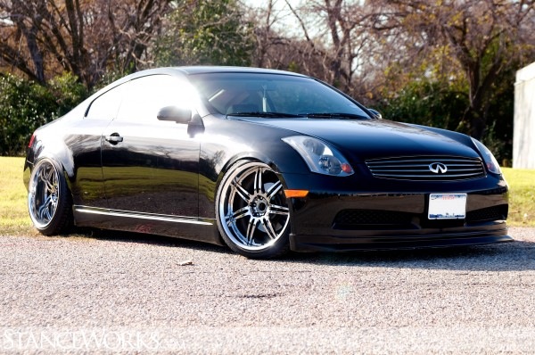

you can do it... its just that you'll need to do some rolling and pulling. You can be like some of my friends from the crew swang n bang... fools are ridiculous for riding with super low offsets and low stances. They call it caveman style! lol heres some of their rides. I know their not MB but I gotta give them some luv since theyre my friends.
Boy Yoshi's car

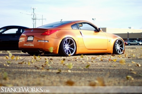

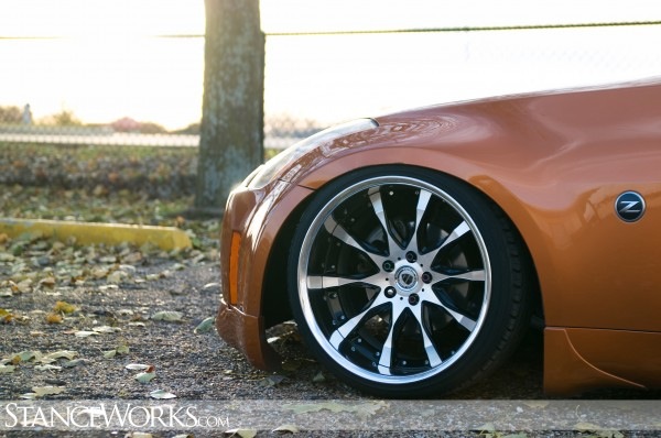

My other friends wifes G
20x10 +19* (currently running 20mm spacer so -1)
20x11 -19
Heres a vid of their shoot for stanceworks
http://vimeo.com/8754583
One of my favorite wheels!!! Thinking of getting them in the future...
