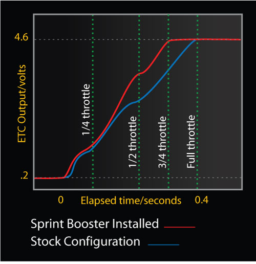

Yes - valexv - It would appear that our throttles are differently profiled. What I don't understand is that the Sprintbooster is a German device from AMB Tuning & I would have thought that RSA cars were the same as European ones as they generally are.
Here is Sprintbooster's own claim - I see nothing wrong with it. It demonstates within reason findings in the white paper with exception of time taken to WOT. Would be more accurate if the horizontal axis was throttle pedal %age of maximum.
they claim that the maximum output is reached at 3/4 of full throttle while the white paper says 2/3... who cares 2/3 or 3/4 as long as its the same idea AMPLIFY AMPLIFY AMPLIFY and use some big words to confuse people THROTTLE LAG LAG LAG LAG and a relatively hight price so u think its a COOL GADGET, A GREAT ELECTRONIC UPGRADE....

Yeah! If you try & nail them down they will say different version. They make different models for Auto & Manual etc & the website does not tell you which one this is.

I know that its not going to create a phase shift, which is supported by the manufacturer's graph as linked above and the independent testing in the paper, let alone figure out some way to send the signal output before it gets the input. Do I have to go spend $300 on an op-amp to get some credibility here?
