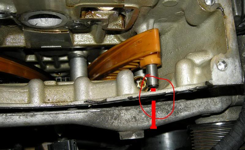

I am removing the cylinder head and there is one bolt remaining. Circled here: Which way does M271 27mm crank bolt turn to loosen?-dscn0914.jpg
The 'slide rail pin' that holds the driver-side chain tensioner is in the way of getting a socket on it. Looks like i need some kind of $150 116 589 20 33 00 Impact Puller for slide rail bearing bolt, basic unit. http://www.samstagsales.com/SirTool/...ompleteset.jpg
Which I'm guessing I can just use something to thread into the slide rail and pull it out the front?

There are lots more pics if anyone is interested. We tore the engine down to the cylinder head and took pics along the way.
We got that ''slide rail pin" out with $2.63 worth of washers and a zinc bolt. F that $150 tool
Here's what it looked like when we started tonight:

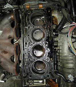

Kind of a long story, quick summary:
Had an issue one morning where the car wouldn't start. When it finally did it sounded like hell. Had it towed to MB and they said the timing chain jumped a tooth and there was bent valves and other damage.
Car is out of warranty and I wasn't paying MB to replace the whole engine so I tore it down myself.
And to my suprise last night I didn't see any damage to the valves after getting the head off. So I'm heading to MB this afternoon with the cylinder head to see what they say.

Sorry to hear that. How many miles are on that engine? There's no nicks on the pistons so valves weren't hitting. I probably wouldn't have taken that head to MB. I would much rather take it to a respectable machine shop and have them take a look.
Has anyone played with the cam timing to see if there is power to be had?

GEDaggett - I'm not sure what you mean, chain guide sleeve? The $2.63 'tool' we created was a 2" bolt threaded just like all the other ones we've pulled from the engine so far with about 1 1/2" of washers on it. There was a little black plastic 'cap/plug' on the front of the timing chain cover that popped out. Pushed the bolt through and threaded it into the post that secured that orange timing guide. As you tighted the bolt it pulled the post from the engine block. I can take a pic the next time I'm over at the garage (if we're talking about the same thing)
[edit] Like this:
