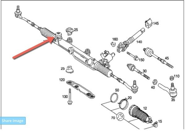

So found a big puddle of power steering fluid. Thinking it was the very common o-ring on the reservoir... replaced that... filler it back up. Next day... new puddle.
Looking again I found the true source of the leak is where the lines go into the rack. It is a round area on the top left (passenger side). Is there a seal or gasket or fix for this... or is this replacing the rack or line?
It is the entry point shown above. Borrowed the image from earlier in the thread.
Thanks

Posts: 118
From: Los Angeles, CA
Yes, and the fix was super easy. I simply tightened everything up. The bolt highlighted in the diagram specifically.
I have no idea how it became loose all the sudden and started leaking really bad. Hope this help and is your issue. Putting in a new rack and hoses will take some time and money for sure. Good luck.
