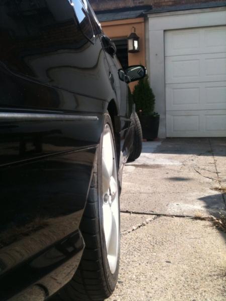

ichiba would the company. They have different listings for front and rear. Heres a photo of my rear lowered.Im confident 15mm will work here , it will be a limit though, maybe even 235 tire width reduction ( will need new set soon anyway)
15mm spacers on 2006 230SS-rear-wheel-gap.jpg15mm spacers on 2006 230SS-rear-wheel-gap1.jpg

ok, first off , why is larger hub bigger then rears? i tried fitting the 15mm H&R spacers onto front hub , and it it only fitted onto the point where that collar on the spacers starts ( whih i think it tapers inwards, making it essentially 66.2 or so) . As far as rears, i had a little rub under load ( 2 people in the car) but thats nothing a little fender rolling didnt cure.
