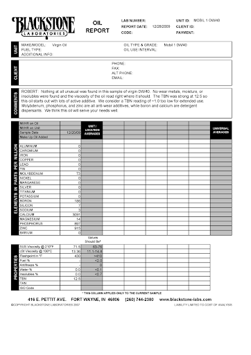

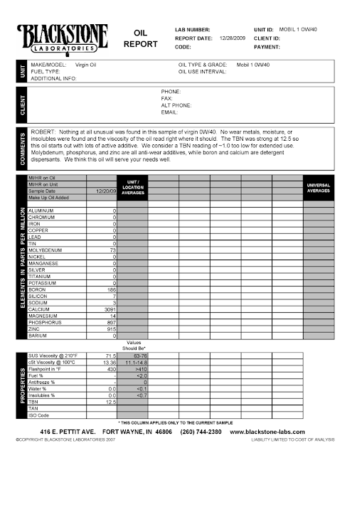

Sorry Matt, I missed this before. I must say, that report is not too bad considering the paper filter. Next report, please get the report with TBN. What I find interesting, is in every report I have seen on the Mobil 1 0W-40, is it shears very quickly to a 30wt viscosity, but your's obviously is well into the viscocity range of a 40wt, being virgin M1 0W-40 has a viscosity of 13.36. I suspect your TBN is very low as the oil thickened that much. TBN is a very good indicator of how long is too long for an OCI.
Attached is a vigin oil analysis of M1 0W-40 for comparison: (Click on the image for full res version)

John - as I said to Greg on the other thread - I would like to see a TAN done as well to see if this is oxidative thickening rather than evapourative. It's unfortunately too expensive for a man in the street to run a NOACK (ASTM D-5800) to check for propensity to evapourative loss.
Will be interesting to see what Greg's sample does regarding viscosity change.

Glyn, just saw that in the other thread. Nothing wrong with Blackstone, but that is why I prefer Oil Analyzers over Blackstone is they provide TBN and TAN with no additional cost.
Taken a closer look at Matt's report and based on the revised universal averages for the correct engine, the numbers all look in line except Maganese. That should be ~ twice the averages and is well over 5 times the averages. Since the VOA doesn't contain Maganese, where is it coming from? The other interesting note, is Matt's air filter is doing an OUTSTANDING job as there is really no silicone when you take into account that M1 0W-40 contains that amount when new.
