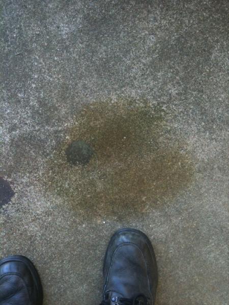

Checked this morning and saw that it indeed has some "color" to it. Attached is a phone pic of it. Ignore the dark spots as they are from an older vehicle. Still no warning light, btw and can't see any visible leak under the hood. Thanks so much for your help.

Do you have a strut leaking?
