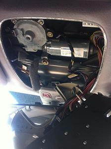

Cool OMG I FIXED IT!!!!!!!!!
Just went Rambo on the wires.....
NOTE THAT I CANNOT BE HELD LIABLE FOR ANYTHING YOU DO TO YOUR CARS OKAY? Try it at your own free will... Worked for my S Class. Hope it does for yours too if you dare...
Once I popped the lenses of both dome lights, and pushed in the 4 metal clips holding the rear view mirror+dome lights assembly, it exposed the wires & guts...... First I unplugged the smallest dual wire harness I could find.... drove for 45 mins, had 10+ volume sudden increases.. that wire didn't work...was prolly the teleaid mic. Then unplugged the only other set of small wires... DROVE ALL DAY NOOOOOOOOOOOOOO MORE ISSUES AT ALLLLLL!!!!!!! Volume at any levels I chose, the amp's bass as loud or little as I chose.... not a SINGLE sudden volume jump. For me, case closed.
Hope this help! Let me know if you got a 2000 - 2003 w220, I can give you a hand quick guide if you are whiling to take all responsibilities of what might happen as damages during the process of disconnecting wires or potentially ripping them off or hurting / scratching / damaging the plastic or metal parts holding the assembly, etc.....
Oh and I am talking about the premium Bose sound system here with stock amp (kept all original speakers minus sub, very good sound already ) disconnected the stock sub (left it in place.. didn't wanna tear the whole back apart), ran the wires from stock amp to secondary amp (JL audio 1000/1v2) to the brand new setup (JL Audio 13W7AE x 2 in a custom box)... The only two problems I found were that auto adjusting crazy volume jump, and that my license plate & its carbon fiber cover rattled like a machine gun.. (had to add a thick plastic foam like sheet between trunk/plate and double sided tape all around the edges of the carbon fiber cover.)
Look at the attached photo, the wires I refer to, are tucked in the left area between the roof & the mount spacing gap area... the two skinniest looking wire sets, in the harness bundle.

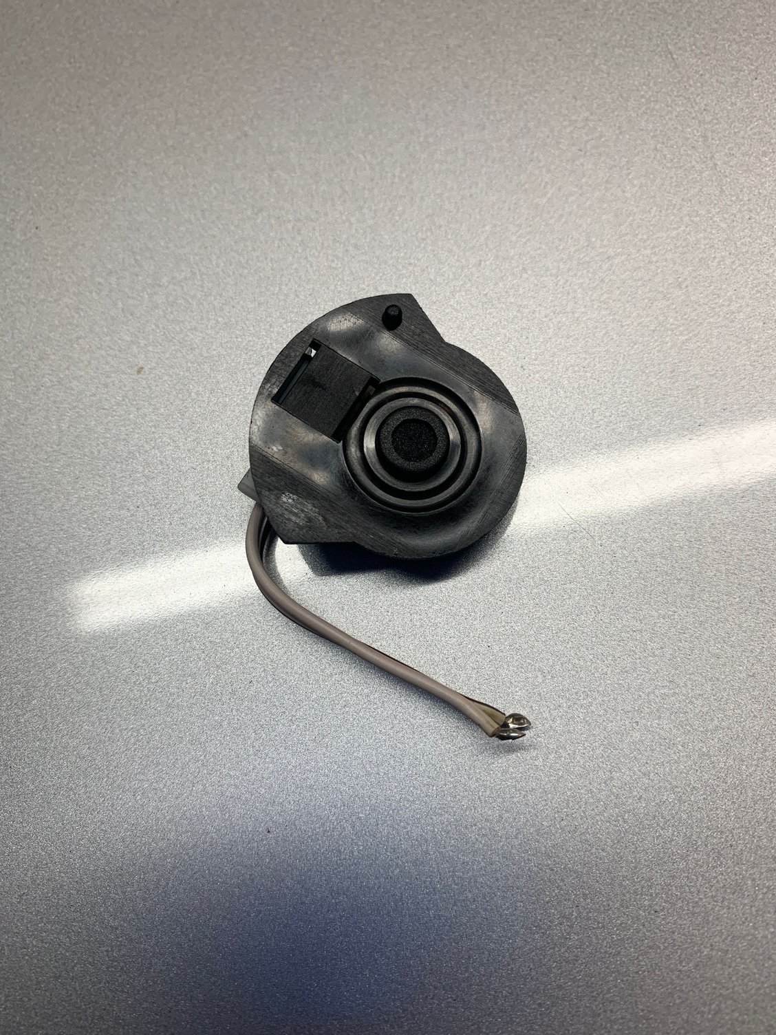

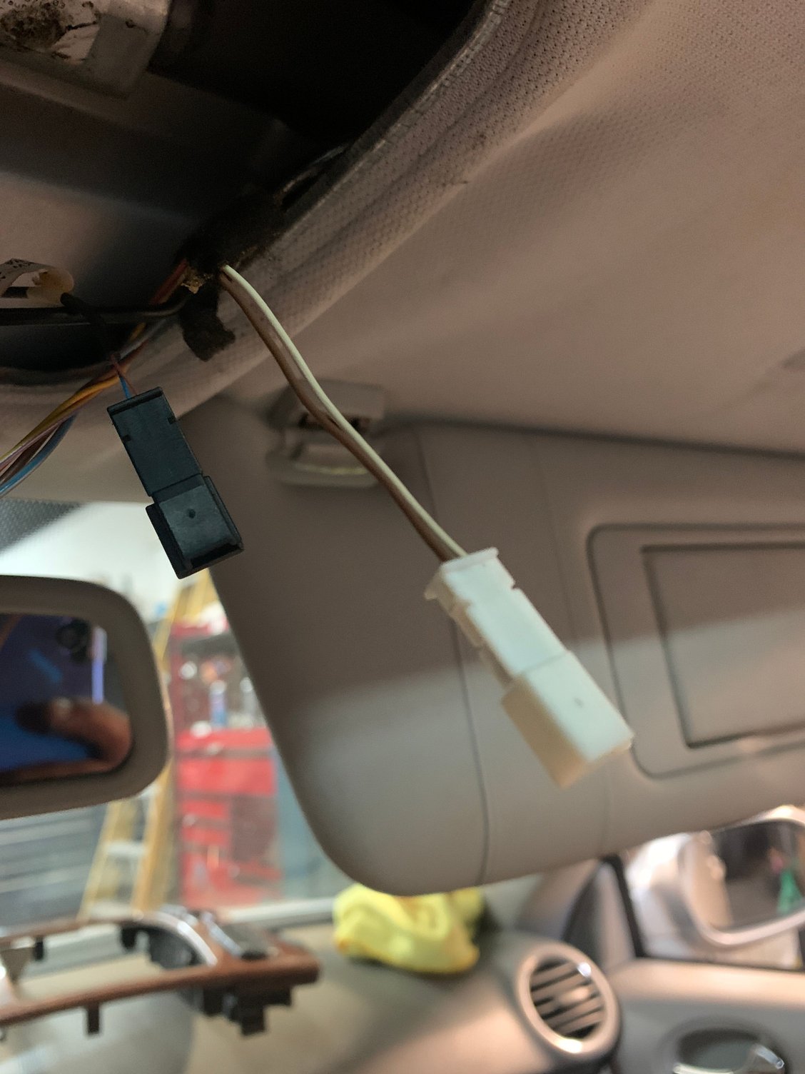

And here is the demon with his fingers on the volume controls
Here it is, remove the lense to the map lights, push two clips then pull down the overhead controls, to the right, of the hole just in front is a brown and white wire. Here is the picture of the microphone causing all these problems, yank it out and you are done- guaranteed!!!
Overhead
Brown and white wires leading to..........
This microphone, front and to the right -take this out and no more problems. And by the way, 30 years
