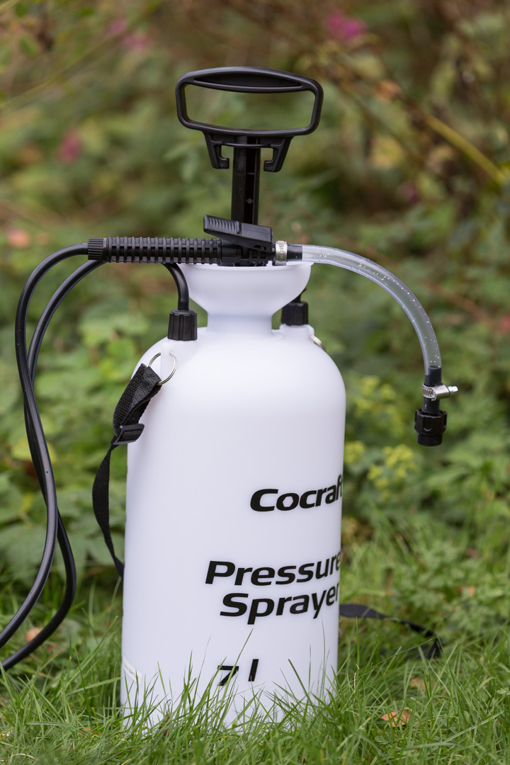

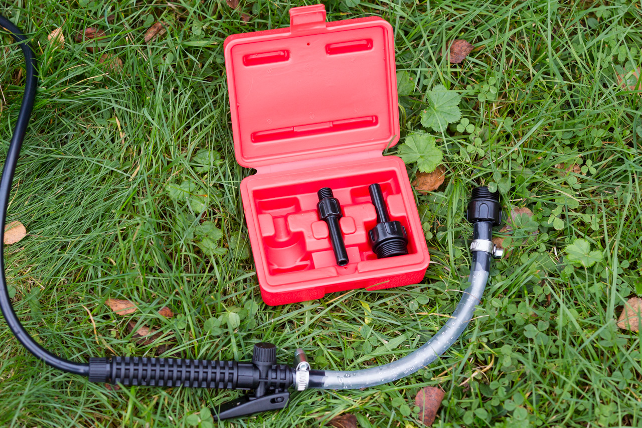

Hello awesome forum members!
I got a bit confused about the correct interval for changing the ATF on the 722.9. Is it a 4000miles/6400km interval or 4000km/2500miles interval between changes?
I have just bought a e500 04 with 8500km on the odometer. Do not know if the ATF have been changed on this car or not. So I will perform the filter and oil change this weekend.
I have made a filling tool that I hope will work. Working fine with water when I just tried it. I have attached a picture of it.
I assembled it from these parts if anyone else in Sweden wants to make one.
http://www.clasohlson.com/se/Trycksp...ft/Pr407917000
http://www.clasohlson.com/se/Slangkl...or/Pr309538000
http://www.clasohlson.com/se/Slang/Pr490412010
http://www.biltema.se/sv/Bil---MC/Ve...ar-2000024070/
Total cost about 55$. But then I now have 9.5m extra PVC hose and adapters for other car brands also.
Thanks alot for the guide and documents!
