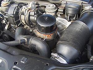

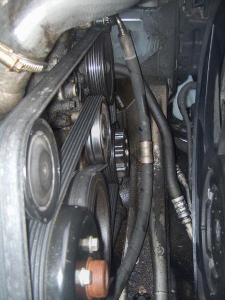

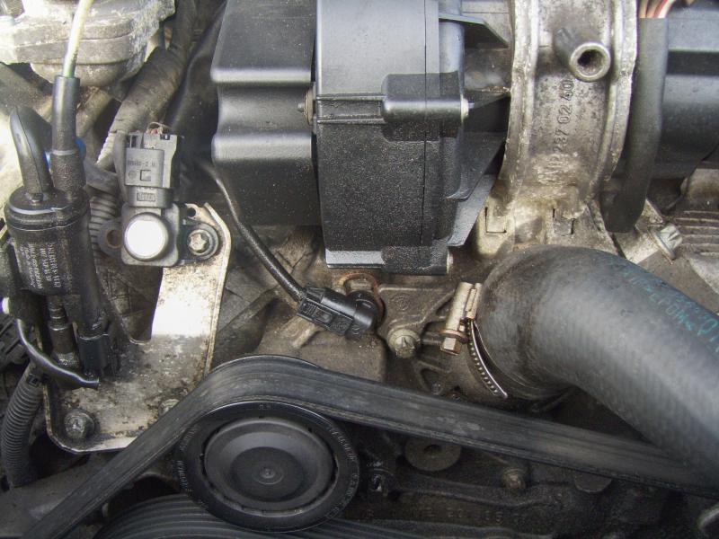

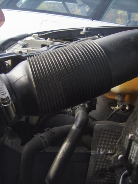

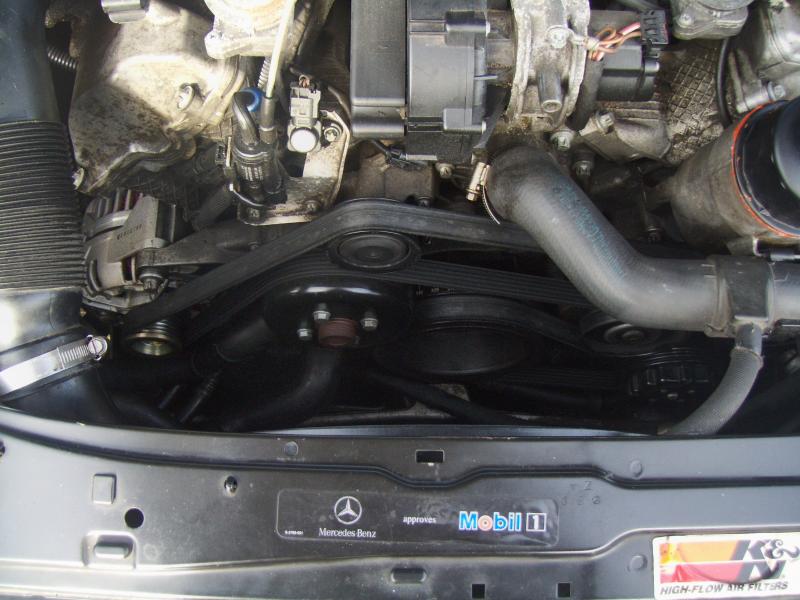

Here are some pics...
Clearly it can be seen the residue of cooked on oil on the outer shell of the oil filter casette...you can see theHi-temp silicone barrier that i made for temp solution...also in my case it dripped on to the belt and the belt took it all over the front of the engine and residue can be seen on the lowerside of the plastic intake pipes...more engine cleaning to be done to get it back to "eat off the engine" condition

if I were you, I would try the following (in that order) -
- new o-ring (the large o-ring that seats between the timing case and the oil filter cap),
- replace the oil filter cap with the stem; I think it's around $30 or $35.
- if that doesn't solve, then the timing case may have been slightly bent... I have not seen this happen before. I would guess the timing case is around $200, labor intensive to replace.

eesjunin, glad to hear that you resolved the oil leak at the oil filter.
Now, clean-up the entire area (around the belt tensioner and the timing case cover) with brake cleaner and see if there are any other leaks - I am guessing there is small leak (from the pictures you've posted earlier) from the timing case cover. There is a small gasket on the timing cover plate (NOT the entire timing case). On M112, that gasket tends to become brittle and leaks oil. See the attached picture with red circle...
If you're not busy today or tomorrow, let me know I can stop by on my way from work (Tewks to Nashua). I'll show you what work I 've done on my W203 M112.
