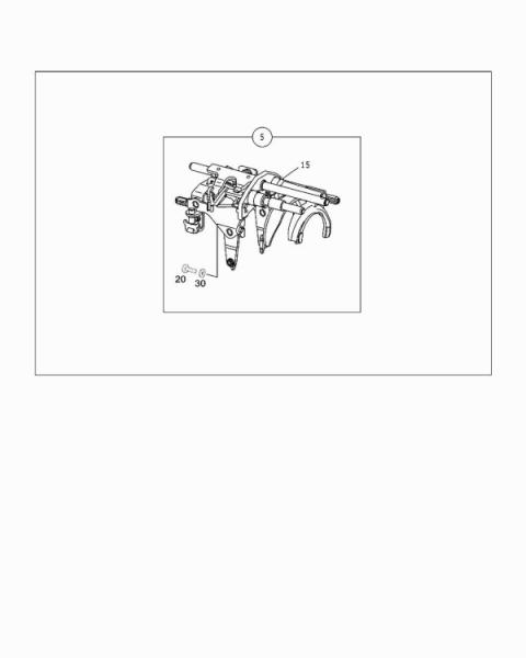

Benz sells this as one unit. You would have to modify the forward speed detents in this unit. The reverse gear detent is built into the transmission casing.
Attached Thumbnails Can the SPRINGS that control DEFLECTION of the 6 spd MANUAL tran SHIFTER be ADJUSTED?-6-speed-mt-gearshift-mechanism-improved-pn-211-260-45-09.jpg

thanx for all the feedback, im lookin for better feel, Viper, great idea, can anyone walk me thru the open it up procedure??? thanx
Old Dec 6, 2010 | 02:46 AM
Glyn M Ruck's Avatar
Super Moderator
Joined: Jun 2008
Posts: 19,942
Likes: 192
You need to get someone to pull out the teardown procedure from WIS.

You need to remove the gearbox from the vehicle & strip it. You do not need to remove the console.
