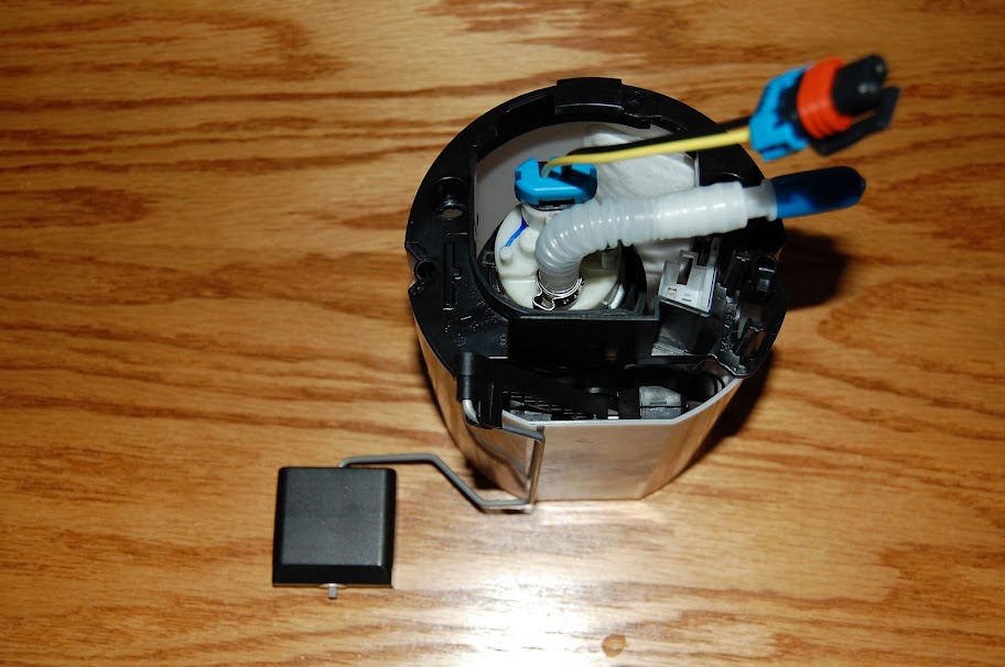

Fuel filter before the pump my *** Look at the pics of the new pump:
So, it appears the change to the late W203 and W204 that eliminated the fuel filter, did NOT in fact change it to before the pump. The pump just clearly has a standard sock filter that almost all in-tank pumps have. So, the late 203 and 204's essentially are running on unfiltered fuel. Obviously another BS cost cutting measure.
I am going to investigate adding an inline filter somehow.

Does it really hurt? I mean if all of them are running it that way is there harm to be done?

Dirt is the killer of FI systems. John - Is there any way you can retrofit the old filter. I guess you don't have all the piping. Is the mounting point still there?
Cheap *******s - Anyway - the pump still ingests dirt as the old ones did other than the nut & bolt catcher.
Presume they have not installed an inline filter up front??? I think you said it was no longer a service item.

Yes, read Glyn's post. Dirt is a huge killer of FI systems.
Glyn, the mounting point is there, but all the fuel lines are routed differently and tucked on top of the tank:
When I went to replace the filter initially, I followed the lines all the way up front, but found no filter. I was told by the lead tech at the dealer, that it was BEFORE the pump and no longer a service item.

It appears at this point the 07's have no filter unless it is in the driver's side sending unit assembly.

Considering the 07 C230 is a flex fuel vehicle, I find it completely asinine that they didn't have a regularly serviced stainless steel inline filter. I will be finding a way to retrofit one. May even install a filter/water separator.

I'm really hoping you find a filter on the drivers side - I'm becoming less optimistic. What the hell were they thinking!
Maybe the bolt catcher is more efficient than we think but I doubt it. The reason the filter has always been after the pump is that it can't live with restriction on the suction side without cavitating at large demand.

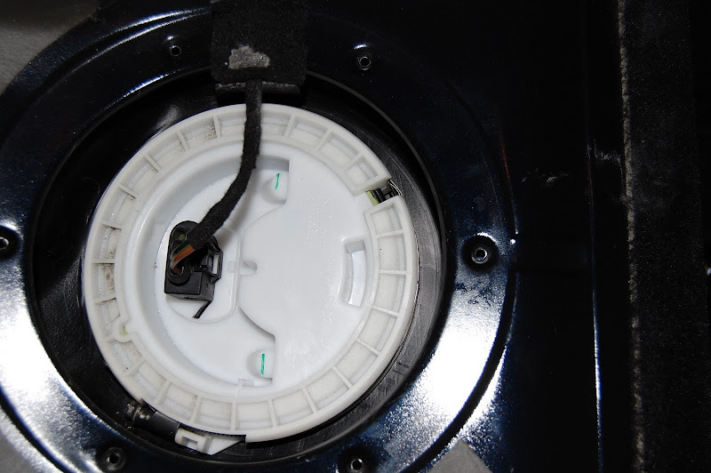

She's ALIVE!
Fuel pump replacement complete. I had just under half a tank and the fuel was 1/4" from the top of the tank ring Good I guess in some ways, less vapor, but had to deal with all the fuel disconnecting and connecting everything. Also, the new seal was very different from the original and creates a much larger gap for the clamp ring, and I already have tightened it more than 8 Nm. This is the new 0199972345 seal, and my orginal 0169974145 was superseded. I did not use any lubricating paste like is called out in WIS part number 0009890160, as I missed that before and didn't have any on hand. I will stop by the dealer on Monday, grab some paste, and a 1/4" torque wrench. My 3/8" one won't fit in there. I will pull the clamp off lubricate the seal, and re-torque the clamp.
Here is a pic of the gap:
