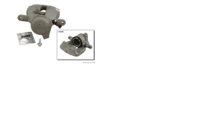

Symptoms: recently changed brake pads that are making a clicking or clunking noise when applying the brakes at slow speeds
Diagnosis: an ill fitting brake pad, most likely aftermarket
Here's what I did on my 2006 c280 luxury:
I do not have the sport brakes, my caliper looks like this:
This does not have to happen to all the sides that the new pads were installed on. I installed the Akebonos on the fronts and the clicking only came from the driver's side.
There are two metal clips to hold the brake pad in. I took both off and FLIPPED THEM. Meaning I put the bottom clip on the top and the top clip on the bottom - both are identical.
THEN I switched the brake pads. Front to back, back to front. Keep in mind that the brake sensor is not on this side (driver's side), it is on the passenger's side.
So all I did was switch the metal clips that hold the brake in place and switch the brake pads.
Clicking is officially gone! Seriously this time. I've driven about 100 miles and it is perfect with NO BREAK DUST! Now my rears are accumulating more brake dust than the fronts!
This is for future reference for anyone that comes upon the same issue.
