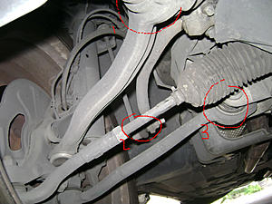

Yes - The castor arm or thrust arm bushes are silicone filled & crack & leak. There are lots of threads on this problem.
See attached pdf on the issue. ignore VIN's. Even the W204's have this problem.
https://mbworld.org/forums/attachmen...h-bulletin.pdf

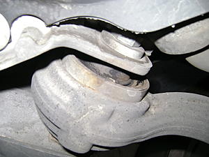

from looking at the DIY sway bar thread ima check if my sways are bad. I dont know how to check if my bushings are bad though..i didnt see any leaks..this is the picture on the left side of the car looks like its been leaking..Squeaky noise may be suspension problems?-f869a762.jpgSqueaky noise may be suspension problems?-b6af7395-1.jpgpicture on the right side of the car
here are more pics..

That castor bush in your picture is finished. Look at the cracks!
+1
You need upper and lower control arms replaced.
I would recommend against replacing only the bushings because usually the spindle joints (at the outer end of these control arms) are also probably worn already, or if not will wear out soon. Easier to replace the entire arm.
While youre at it, check your sway bar endlinks by holding and shaking it at both ends. If you feel any play, you might as well replace them too.
Other parts to check are the outer tie rod ends. Check for play at the outer end where it connects to the wheel hub.
Trust me, its easier to replace all these at one shot than replace them one at a time, do an alignment and then find out that something else is worn out a few months later. Learnt from experience.
Check the other side too..they usually tend to wear out in pairs.

With newer cars just press in new bushes. All of my ball joints are still original & have zero play in them. My suspension is absolutely silent.
These cars go through about 4 castor bushes to one camber bush. The camber bushes seldom fail. The bushes are cheap.
