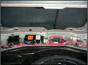

This happened to me couple of times. Once I hit a bad pothole and doors unlocked. Once I took a fast turn and heard a "boom" in the trunk and it unlocked the doors so I'm guessing something banged against the wall. Although it might also be a faulty sensor if it unlocks during normal driving

Greg - I'm stumped at the moment unless in newer cars they use the ESP, Lateral accelerator sensor/Yaw sensors to pick this up now. It used to be near the temperature sniffer in older cars. See the ESP modules ahead of the spare wheel well below. It's not listed as a rear SAM module. Let me keep scratching - Maybe Trey can educate us or Russ can tell me why I'm confused regarding the rear SAM. I know the impact sensor was not a figment of my imagination on early cars. Belt tensioner & airbag sensor is in the center console area.

Let me see, I once looked into this long time ago and what Glyn posted looks familiar.

I think it has to do with the yaw sensor. The yaw sensor constantly measures for stability control so I have a feeling when this bad boy gets shocked it sends a signal and unlocks the doors. I don't think it's the rear sam but I could be wrong.
