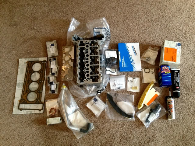

Here we go. Finally got my parts, now the fun begins.
Anybody got a map......

Good luck on your Grand Adventure, Hogger! Although in my mind, you're already started!
I'm sure Glyn has a map for you. Have you thought about getting the DVD workshop/parts manual?
I forgot to ask - Won't you have to have your valves and seats ground? Or do they do that for you with a new head now a days?

Thanks!
I did subscribe to AllDataDIY. It has been really helpful. Well worth the $20 for a year.
Already got the balance chain on, and going for the lower guide and tensioner. The thing that has been the most work is getting all the surfaces clean for re-assembly.
The new head came with new updated valves and springs. Apparently in 2005 there were some changes made to the valves on the M271. It also comes with new guides and seals. Pressure tested, cut valve seats, lapped valves, and new exhaust manifold studs.
Should be just plug and play
Jordan

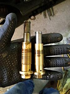

OK, so the new tensioner(right) has a shorter spring shaft compared to the old one(left). I was reading that on an M111 you are supposed to take it apart, and move a pin and springs. Here is a link Tensioner install. But on my tensioners, there is no way to unscrew it and open it up. The brass part is all one piece.
So, I'm wondering if something happened to the old one, and over time pressed on the guide beyond where it should be, resulting in a stretched chain????
Just an idea, but should I just install my new tensioner as is?
EDIT, just found an M111 tensioner, they are much different than an M271 so you can disregard the link. The old tensioner has a light spring load, and gradually get harder as you press it in. When it gets to the same length as the new one, they both feel like the same tension.

My understanding is that the tensioner is use once & only release on fitment. Let me check. It partially depends on oil pressure.

2009 ML350, 2007 GL450, 1963 GMC, BMW 325i
That's what I'm finding. Everything I've found just says pull the old one, and install the new one.
I was thinking oil pressure may play a part too.
Too late anyways, it's in with the front timing cover installed.

See oil feed hole in your pic!
