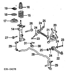

LILBENZ230, what exactly from this diagram did you replace?

The bushings on 22 and 24

Did you mean 21 and 22. 24 is a washer.

21 and 22, yes, sorry.. lol
