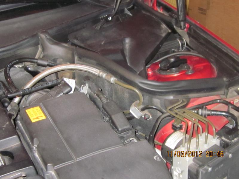

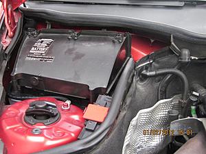

Anyways,.... top of strut tower should look like this,... or at least it does on a 2003 coupe,.... notice the reinforced area,....

Originally Posted by SunnyRayToronto
Ok,... "its not mine,.. but its for a friend,...."
I certainly wouldn't trust my life to that car with a critical component like that is cracked,.... and just a pot hole away from falling apart.
Yeah that is what I was thinking last night when I saw this post. Nice grab of the strut tower pics. I was looking last night and couldn't find anything.. the google was failing me.
I second previous repairs to that tower. Also I suspect that suspicious bolt is due to his bag system. I'm not an expert when dealing with extremely lowered cars. But I suspect it wasn't done with "quality" components.
Tell your friend to not drive that car at all.. not even to a repair shop. Get that thing towed on all 4.
