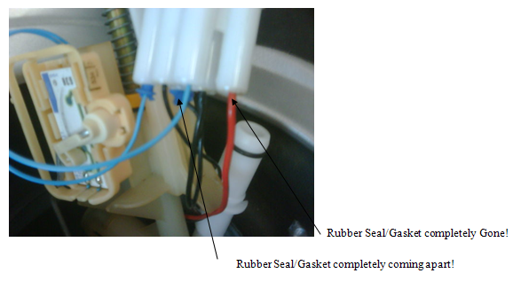

I checked Schrader valve for pressure by pressing with a screwdriver, and there was no pressure.
So, I decided to check both the fuel pump (passenger side) and fuel level sending unit (driver side) for any signs of a bad connections or for something that did not look right. The only thing I noticed on the electrical connection of the fuel sending unit was a brown spot on the plastic cover that cover the 6 wires that connect to the unit and also the rubber seals (Blue and Red), that I guess is to prevent the gas from getting in to the electrical connection, they were all coming apart and breaking down….see picture. So, my question is, Could it be that the unit shorted out because of the gas getting in the connection? I am waiting for the rubber seals to plug it in again and see what happens.

I suspect that the fuel pump has failed. When last did the car have a fuel filter?
Good luck!

Yes, CPS and Fuel Filter have been replaced. One thing to add is that when I checked both fuel level sending unit and pump, both tanks were completely empty. Besides these units what could cause for the gas not to flow.
Thanks....
