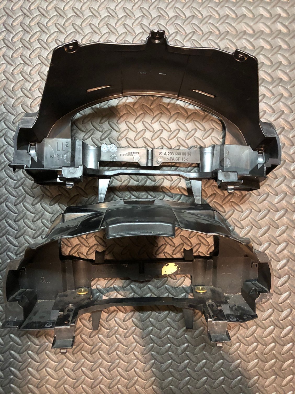

Please, share the PHYSICAL alterations needed...I have my w209 and w203 cages ready to machine/Dremel.
I know there will be a little gap in corners.
Old Aug 18, 2020 | 07:30 PM

Other than the EEPROM...and initialization...
What are the physical changes and can it be done without removing dash or dropping steering column to remove w203 cluster cage?
