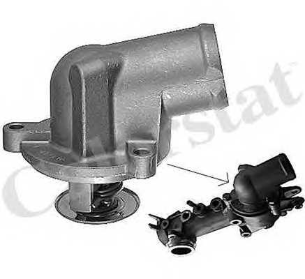

Is this the one you have..?

No that one have a little pipe, mine don't

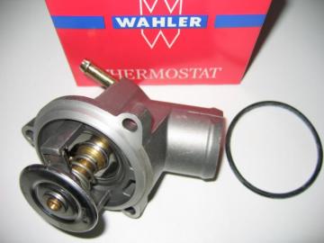

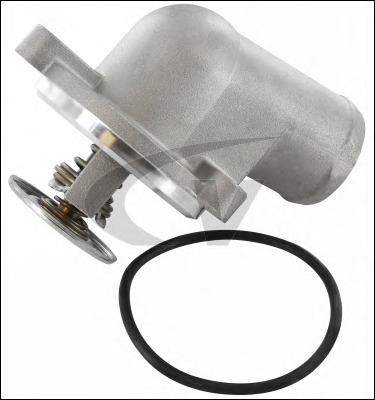

Ahh, i see, i think this is the one you need,
C230 thermostat and to say hi!!-1112001715.jpgC230 thermostat and to say hi!!-11120017151.jpg
if so, you can go with brand named "Wahler", it's an official supplier of MB T-stat,
most of MB part shops has it, just give them the part #, which is: "111 200 15 15", or "111 200 17 15"..
http://www.ebay.com/itm/Mercedes-W20...-/360679848278

This part # "111 203 10 75" means you have the first version of M111K Engine..

I asked the dealer here, they said "111 203 10 75", is been replaced to "111 200 15 15", or "111 200 17 15"...
