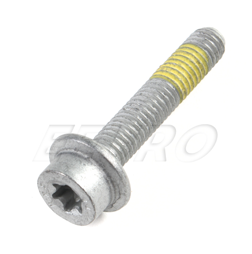

Originally Posted by cm60k
As i remember; its M6X30,
#: "140 990 46 01" or "003 990 02 12" or "002 990 53 03",,
Attachment 293225
ECStuning got them: http://www.ecstuning.com/ES1688417/ES1617053/
ZAYED,,
Thank you guys!
