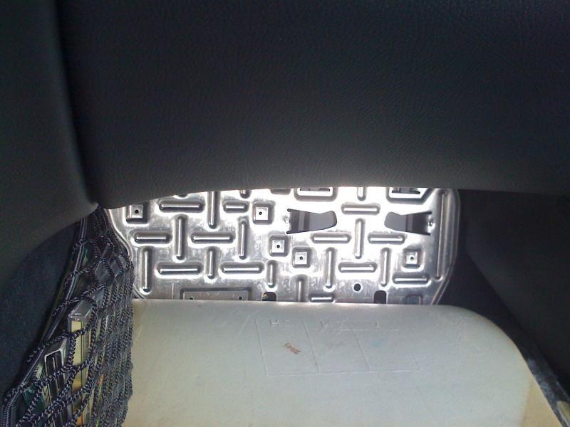

How does one get into the TCU as far as separating the carpet is concerned. My transmission is downshifting pretty hard again and I don't want to go hunting for expensive repairs that may not resolve anything.

Pull back the passenger side carpet to expose the kick plate. Undo plastic nuts, swing back kick plate & you are in.
Awesome pics! Appreciate it.
Should I look for fluid around the connector area? I haven't noticed any wet spots in my carpet, but who knows.

Update:
I took it all apart, and after about 30-40 mins of trying to figure my way around, I realized how easy it all really was. I think if I had to do it a second time, I'd be in there within 5-10 minutes.
That aside, I disconnected the 2 connectors and realized there was some fluid near the end of the colored wiring leading into the black connector. The TCU itself was bone dry and didn't look to have any kind of damage. I forgot to bring a brush, so all I could do was wipe it off and check around for any other damage. I did notice that the wires were zip tied to the metal foot plate, which leads me to believe someone else may have already been in there previously.
Either way, is there a specific way to clean the connectors and take away the fluid? I'm not sure if any has gotten into the connector itself, and I was only able to wipe it up around the outside. I haven't tested the car to see if it shifts better, but tomorrow I will know.
I just want to tear it up again and make sure it's 100% clean, just not sure how.
