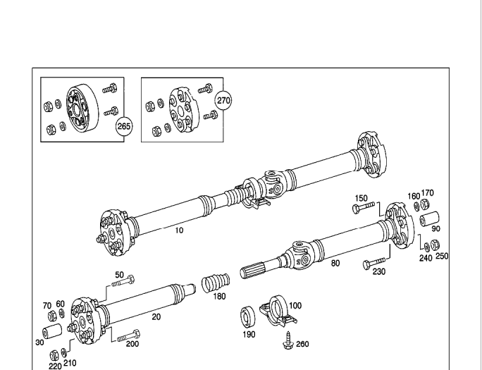

The problem can be exacerbated by any driveline play. Check rear transmission mount, Propshaft flex discs, Centre hanger bearing & grease the slide/spline.

Hey Glyn, what grease do you recommend and can you specify which spline to grease?
I want to check into that. I sometimes hear a weird metal squeak when parking and switching from D to P. Almost like brakes are squeaking, but I believe it's from the prop shaft...

Flex discs are more likely to creak but propshaft spline should be greased. You might have to fit a grease nipple.
Use any High Temperature Lithium Complex No2 Grease. 3% moly versions are a benefit in this application.

thank you, I will inspect the parts. Never noticed a 'boot' over the spline there...
