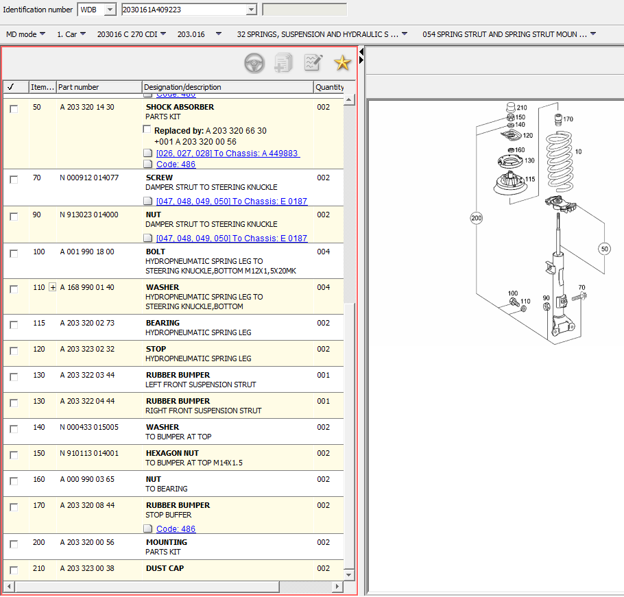

Thanks a bunch. So it is really an 01? All my paperwork says 2003. That's Italy for ya. I ordered the control arms/steering kit, and the strut bearings. I guess all that is left are the struts and rear shocks.

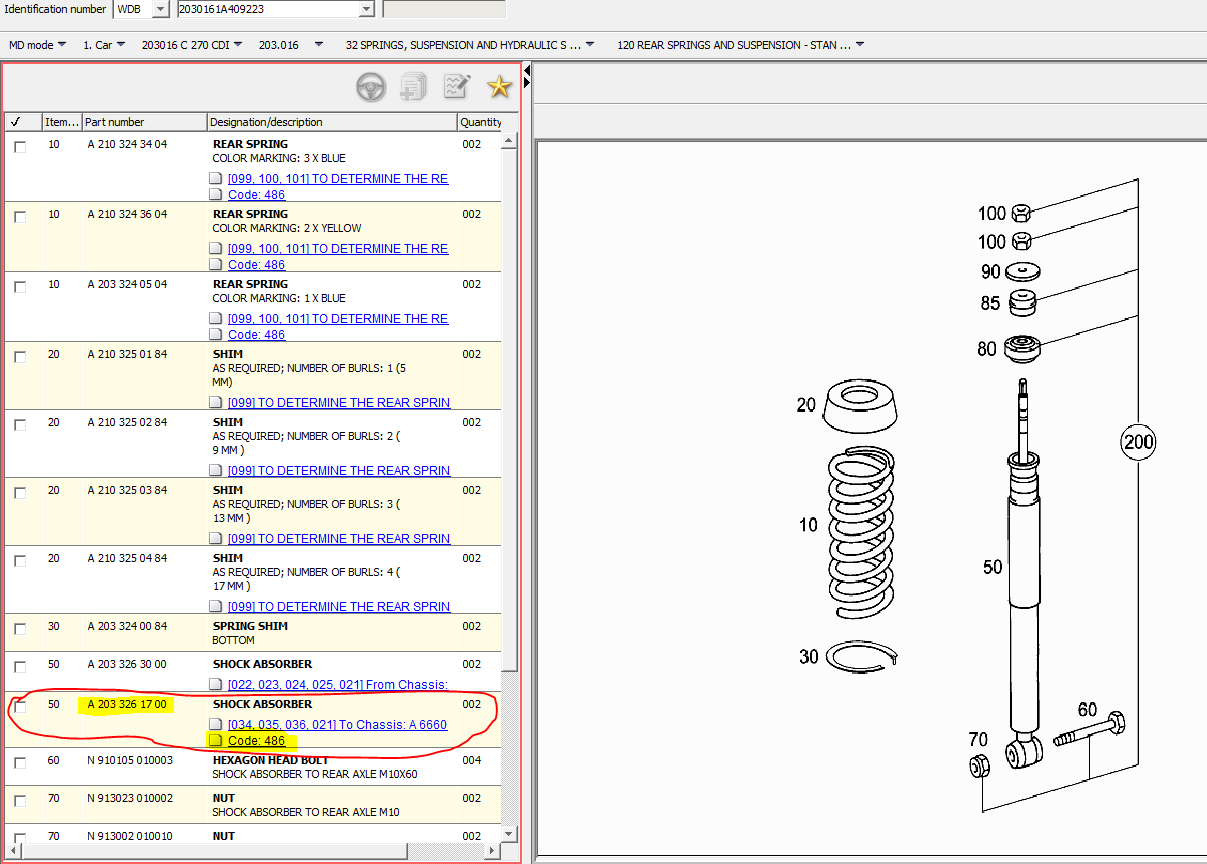

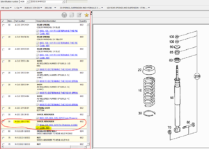

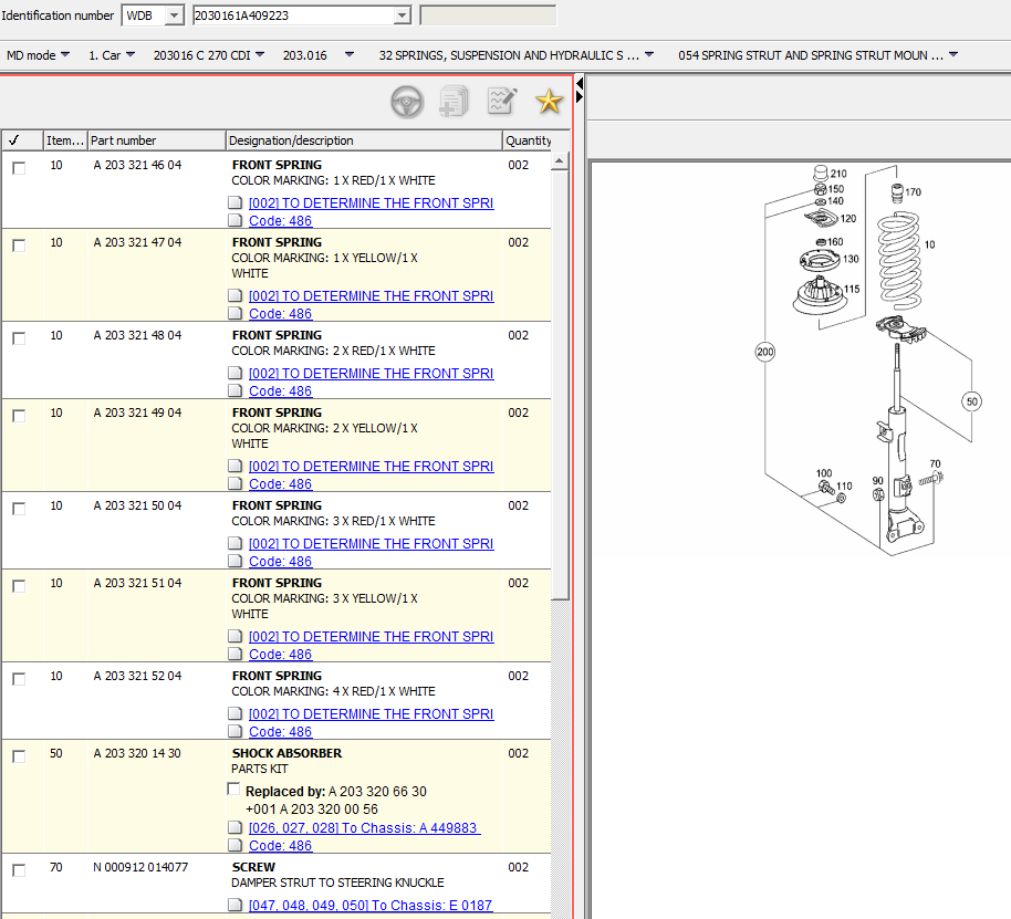

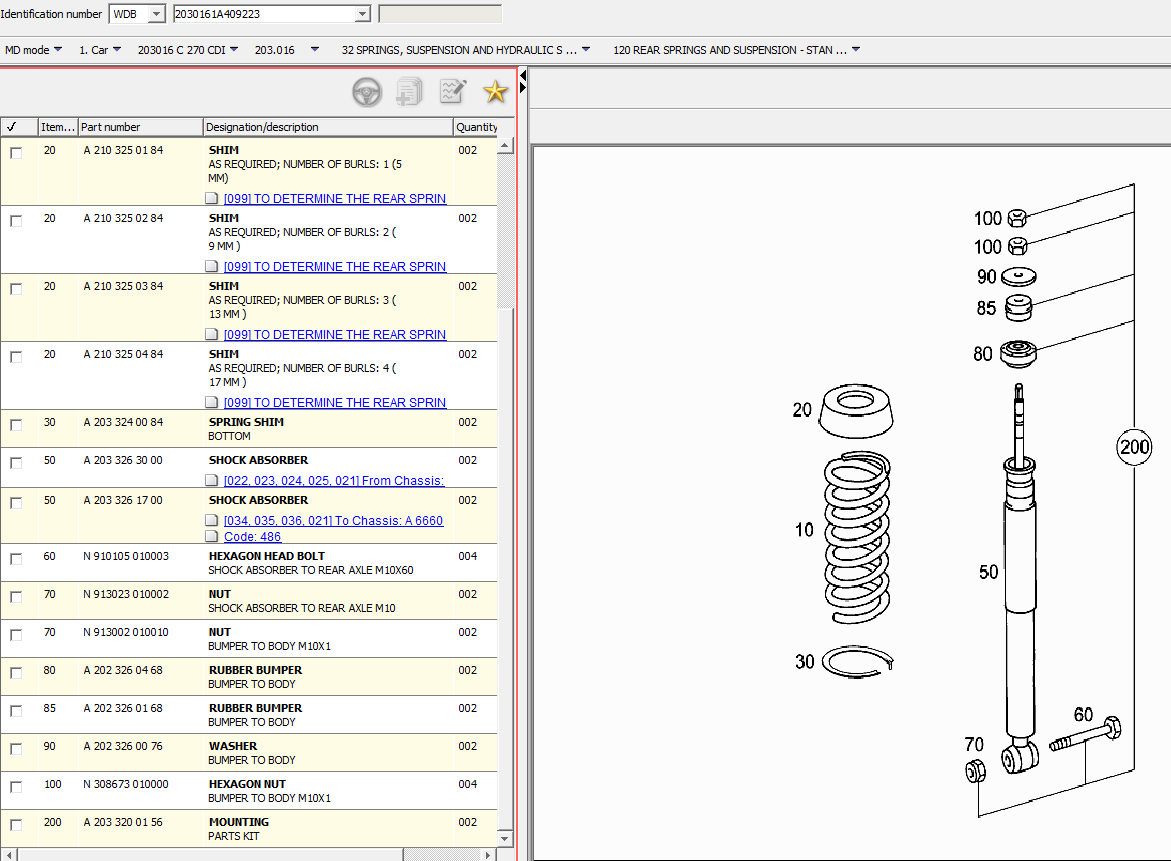

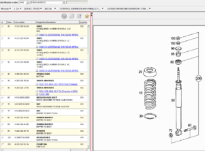

I got the numbers you need. Sorry on the late response. Make sure it has the 486 (sport) code. I have also attached images of all the part numbers.
Front Shock - 2033206630
rear Shock - 2033261700
Attached Thumbnails Recommendations for new struts/balljoints (C270)-c270.png   Recommendations for new struts/balljoints (C270)-c270_1.png   Recommendations for new struts/balljoints (C270)-c270_2.png   Recommendations for new struts/balljoints (C270)-c270_3.png

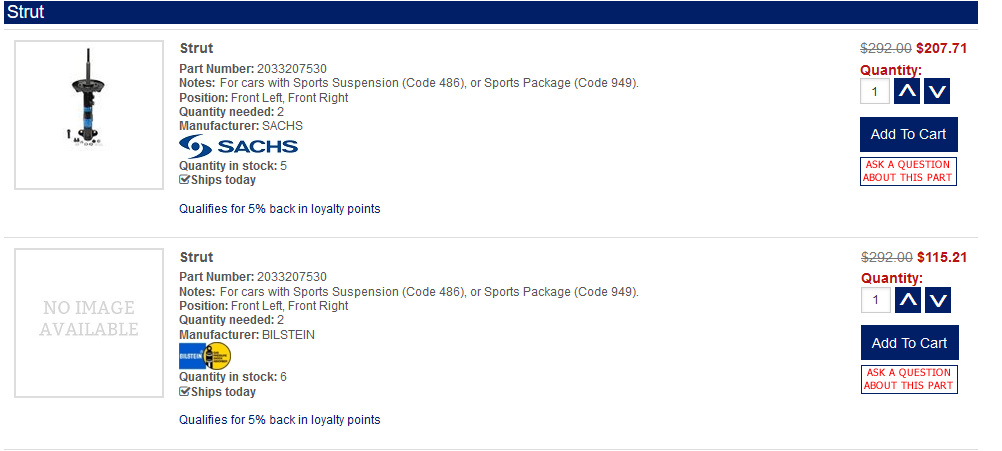

I found some Bilstein struts on ebay for $126. Sachs brand for $164. Rears are same brand and about the same price at $100 for a pair. Recommendations?

I went with Bilstein this time. There was a huge price difference between Sachs (OEM) and Bilstein. This is the first time I have used Bilstein but I'm sure it will be similar.
I'm just doing it all. The complete front arms/links and the complete rear arms/links. If you have never changed them might as well.

Sorry, its been a busy week. Where did you get that price quote in the picture? I think I might as well order them.
