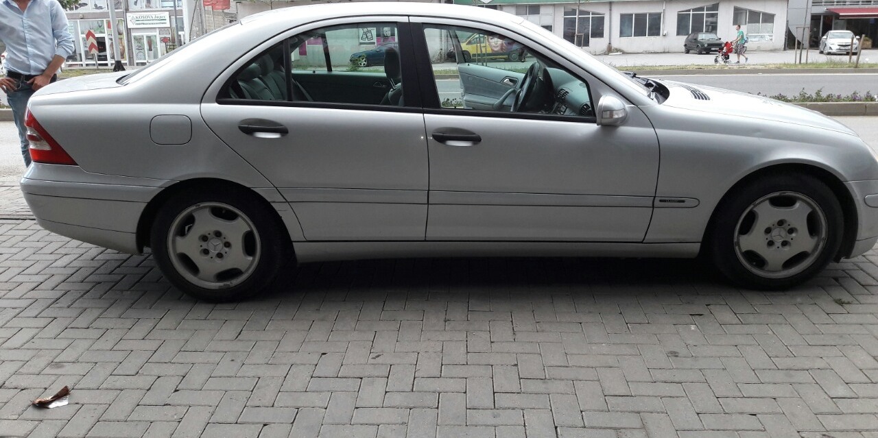

I am about of buying this C220 CDI 2003 with OM646 engine with 2680000km
I have recorded the engine and attached some photos let me know if it is worth paying 6500euros for it?
Please be patient and listen (MP3) to the sound of the engine, there is a "phiissss" sound at the end of the clip that is kindda getting me worried, is it coming from turbine or it is normal?
If you cannot hear the MP3 file for some reason let me know i will PM you, because i like the car and if it isnt something bad with that engine sound i will buy it on monday.
Please give me an answer because i have put it on hold til Monday!
Best regards,

Sounds ok but it cannot be worth that much.
It is pre-facelift (rust issues) with fabric seats, oh and I think you have an extra zero in the mileage (I hope !)
You must drive it hard and use kickdown to check that there are no turbo issues.

I've had CDI mercs all my life and it sounds ok. There are million small things wrong with those 2001-2004 cars however so try to get the price down atleast 500e-1500e.
Without knowing the repair history, I could bet atleast these are broken/going wrong:
-Heater booster for CDI engines (for winters, no idea of your country do you need it)
-Inlet manifold flaps, leaking manifold
-Check main thermostat + small thermostat (does it warm up to 90c at all?)
-Check when injectors have been replaced, they are longlasting but it sucks to pay around 500e / piece to replace
-Engine mounts + transmission mount
-Endless misery with the AC stepper motors/links
alecmascot: Maybe the price sounds high for you, but the same cars can cost much more in some other countries. Pre-facelifted W203's here with similar milage are nearly 8k. And 99% of these have fabric seats even in Germany...
