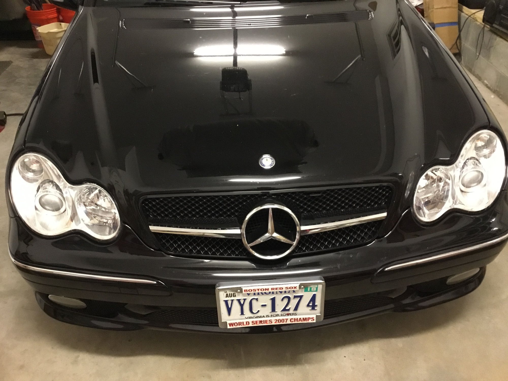

Also thinking about this grill with the logo in the grill like the newer model to also give this beauty a facelift
I have that grill.
I think it does make the car look more up to date. I was aware of the information Red Gray shared with you before I bought my car. You do need to factor it into your decision making. If you are willing to DIY maintenance and repair work that will be an advantage.

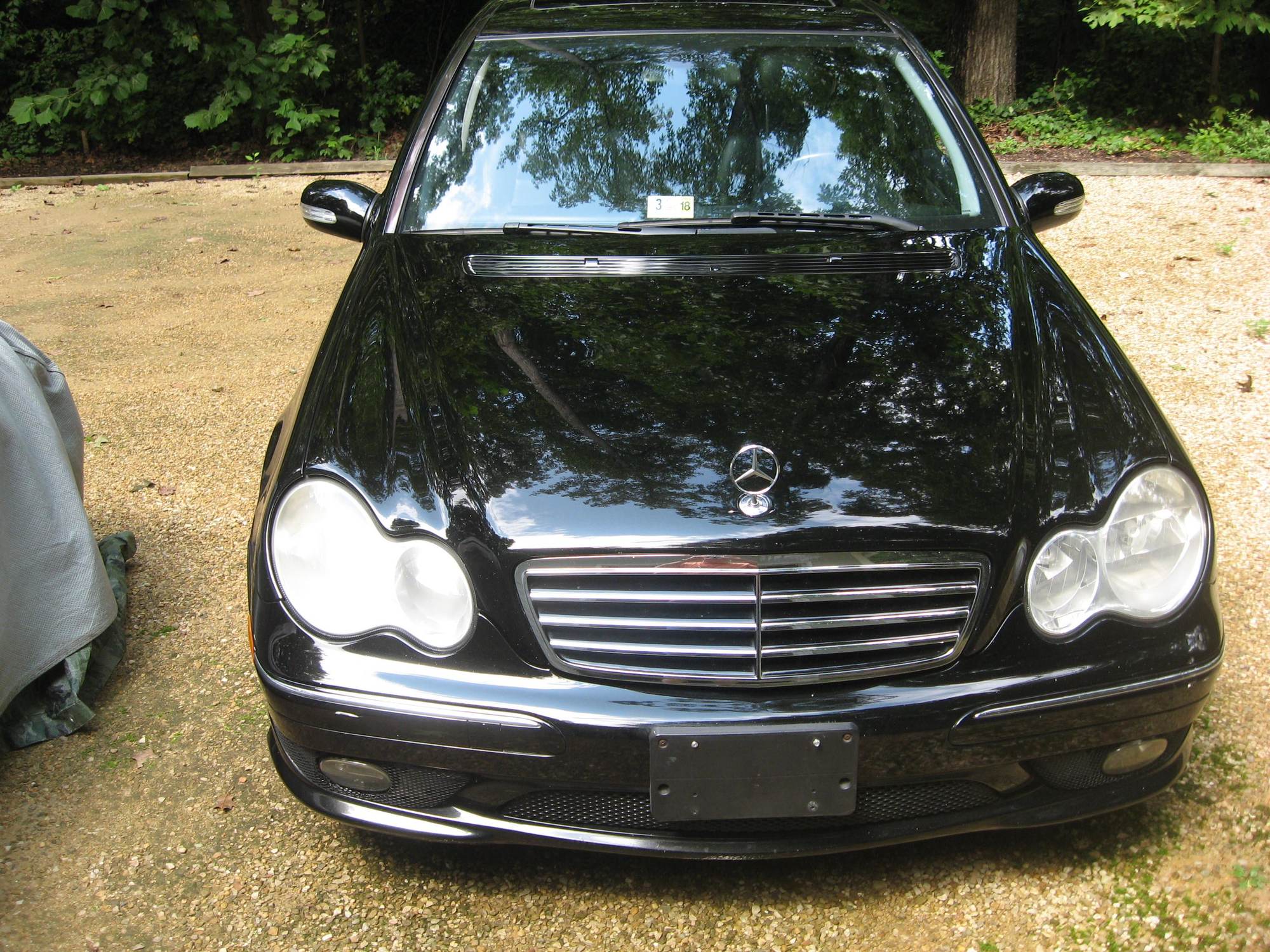

Originally Posted by RedGray
Fwiw, I actually like those headlights.
If you are referring to my headlights, those are OEM Bixenons that I bought from a wrecking yard. I also picked up a set of new covers on an auction site. Here's a picture of the car before I changed the grill and the lights. I'll let everyone else judge which look they prefer.
