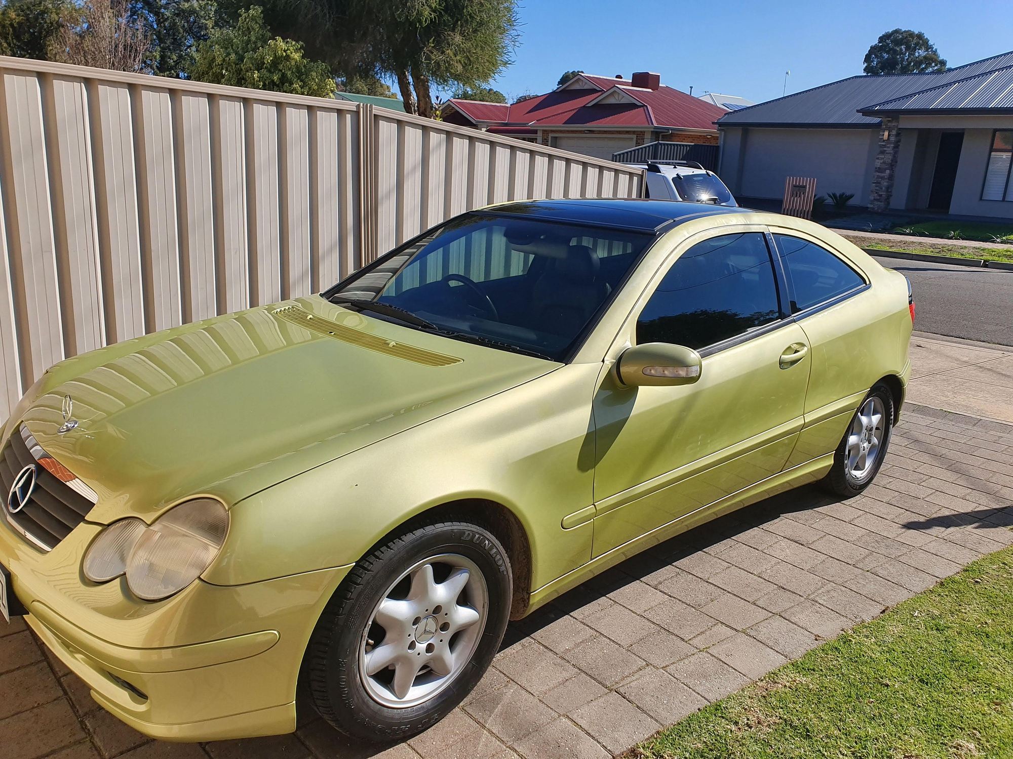

I found a seconds motor happy bout that and yes I've already looked at the threads from David and they are awesome and all the pdfs are very useful as well but I think there is couple missing like installation of motor and more about motors if you know of anyone who has those pdfs would be great, unless there there and I just am blind?
And yeh I love the colour to of my car
I've enclosed a picture of bumper?
Thanx again for response hope to hear back soon?

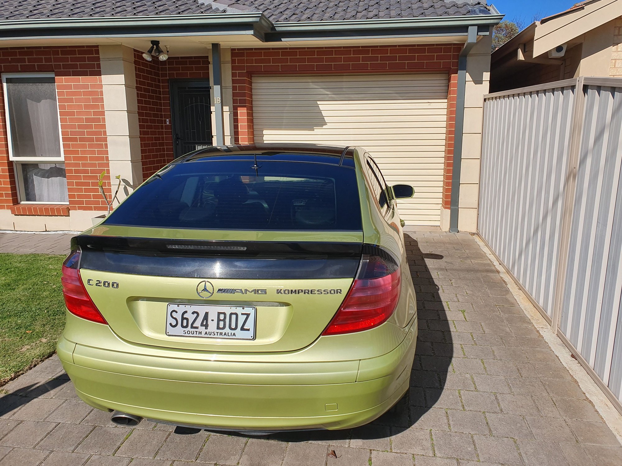

And sorry, but an AMG badge doesn't make your car an AMG.
Check the differences in the front bumper in the photo I posted vs.
yours. We never got the AMG styling package here in US but some people
mamaged to import the bumpers and side skirts.
There's one guy in Peru with an honest to god C32 Coupe...but that's the only one known exist.
Time to bust out some fishing line and get that thing off !!
