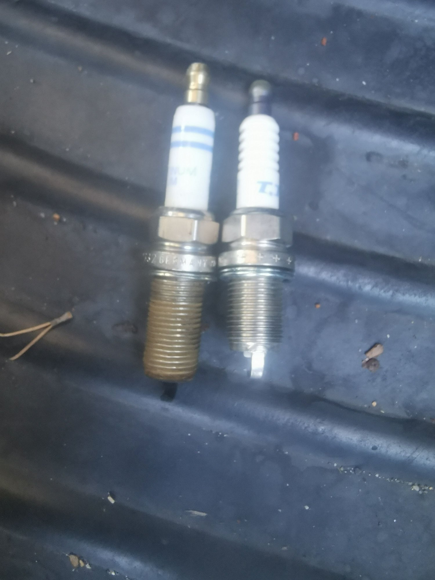

Ok, got the torx set, ratchet, unscrewed it, but I found out the new one is not as long as the old one. Will it still work? I have not installed it yet. Have a look at the pic:

Definitely do not fit shorter ones. They are a certain length for a reason. If you were to take off your cylinder head the tip of the plug would just be showing. The shorter ones would be recessed so slowly damaging the exposed threads in the head.

Yea, I read through that thread through and through. Some folks go different types than the stock. Some swear by stock only. When I went on amazon, I typed my type of car, and then the ones I bought showed up. So I bought those. But looking at it now, i say f** it, not gonna put that in my car. I just bought the exact model number as what was in my mercedes, the bosh fr6mpp332. The one on amazon says double platinum, so that's considered great I'm thinkng.
