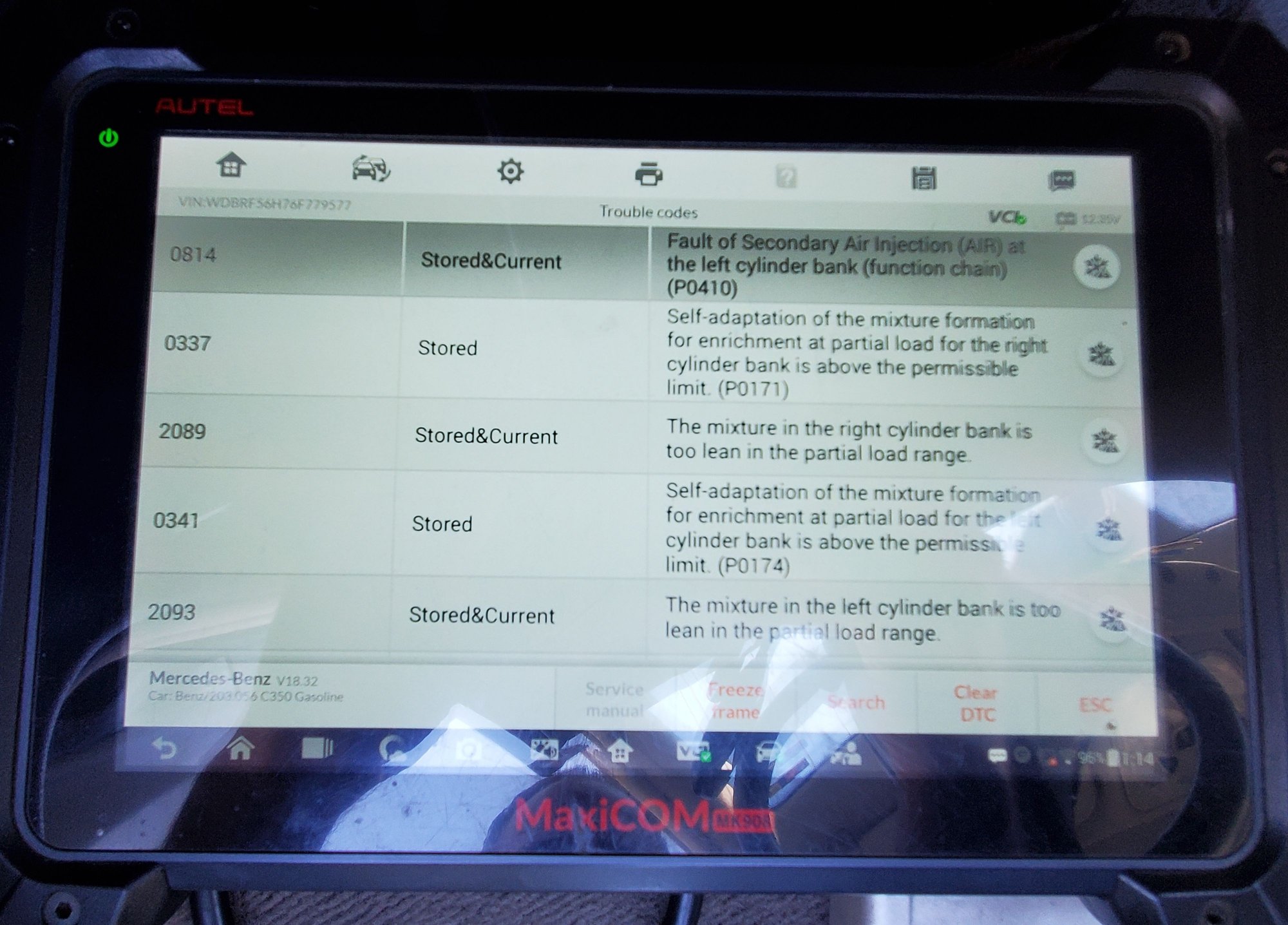

Old Nov 5, 2021 | 05:36 PM
Bimmerod's Avatar
Joined: Oct 2021
Posts: 16
From: California
2006 C350
UPDATE
Here are the scans from the indie shop
1st page
a few more on the 2nd page
Owner thinks it's the MAF sensor assembly.
Thoughts?

The MAF isn't expensive. I'd probably try swapping it out first as well. If that doesn't solve the problem then I'd look into the intake O2 sensor(s) next.
Be sure to go OEM or quality aftermarket only.
