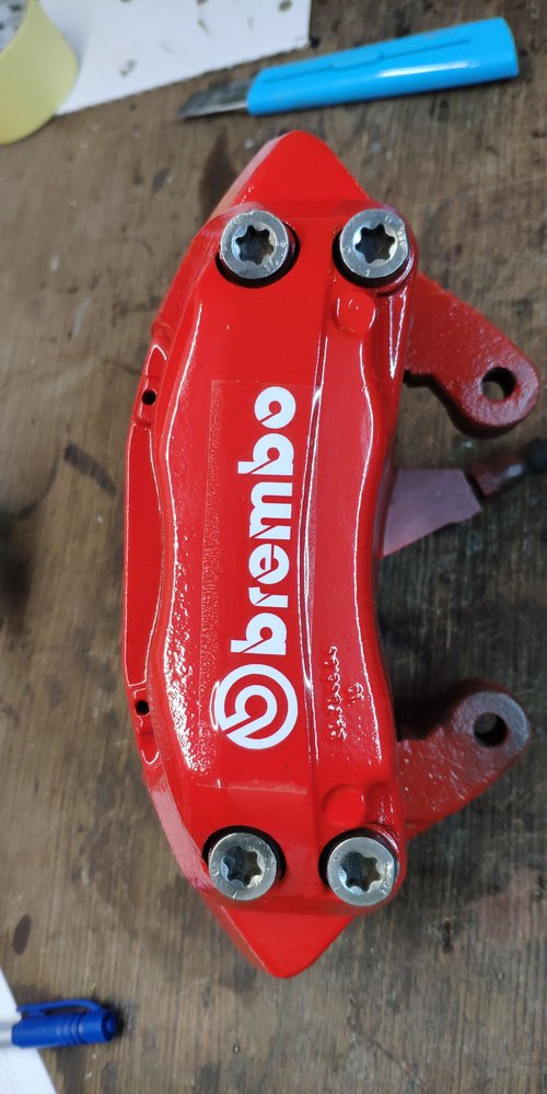

Was busy with work. Found 330mm discs and guy had 4pots that came off W203 so I bought them. I'm gonna sell W220 calipers.
I took some measurements and can confirm that 6mm spacer will be needed to install W220 calipers(as long as they say "330" on the side) on W203. W220 are easier to find as cars are cheap. Calipers do look the same except the mounting ears. Didn't compare piston sizes.
This mod will work with W203 330mm disk. Don't have W220 disk on hand but offset is not the same as W203 one.
Left W220, Right W203.

Lookin' fresh
