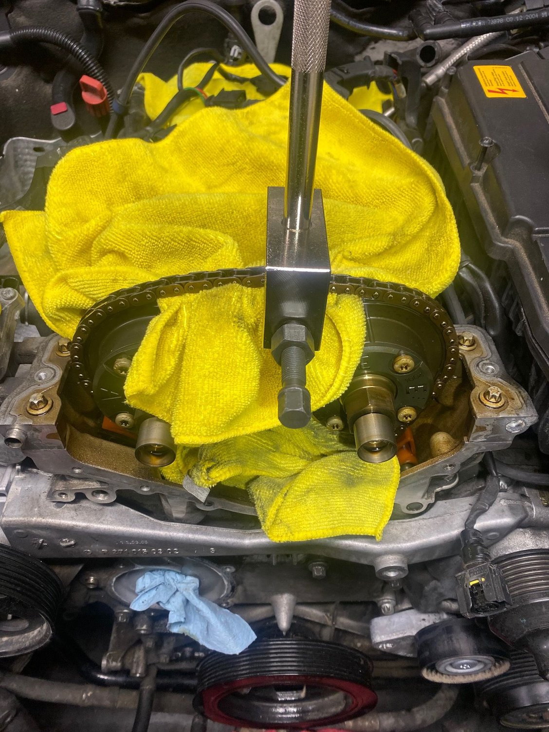

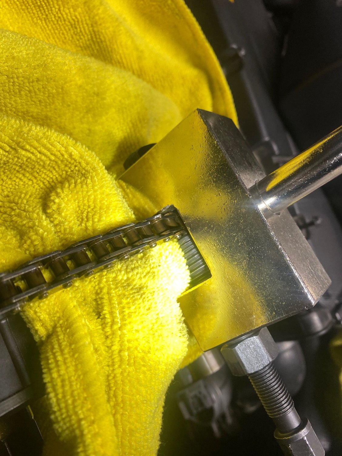

At this point I have removed the sprockets and broken the chain in addition I have removed the camshaft housing as well ( changing the hydraulic lifters preventative) and removed the chain tensioner which appears to have been broken.
The only thing that had my head scratching was placing the camshaft locking tool on at first it didn't sit flush and it felt forced because the camshaft were slightly not dead on. What I did was use a 27mm socket that I had and just moved it slightly so I can tighten the tool down. Did this on both sprockets and worked fine
I need to now drop the pan assuming there is going to be some sprocket teeth floating in there not looking forward to this...

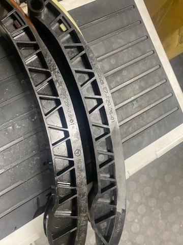

I've decided to remove the lower timing case because my chain guides have groves in them and need to be replaced. The chain and guide kit is the Febi 44974 which I mentioned but it is in fact a Genuine MB part the guides say JWIS on them and the MB logo and part numbers have been removed see photos. This leads me to believe my chain is also MB part as it has JWIS stamped on the chain. The tensioner is blank but so was the original. Another reason I am removing the lower timing case is because I'd also like to replace the bracket for the tensioner and take a look at the other guides and crankshaft sprocket see if there is any severe signs of wear. I am currently at the point were I need to drop the oil pan which hopefully I can accomplish tomorrow.
Here are additional parts I ordered to replace due to the removal of the lower timing cover these parts should be replaced if anyone decides to do this.

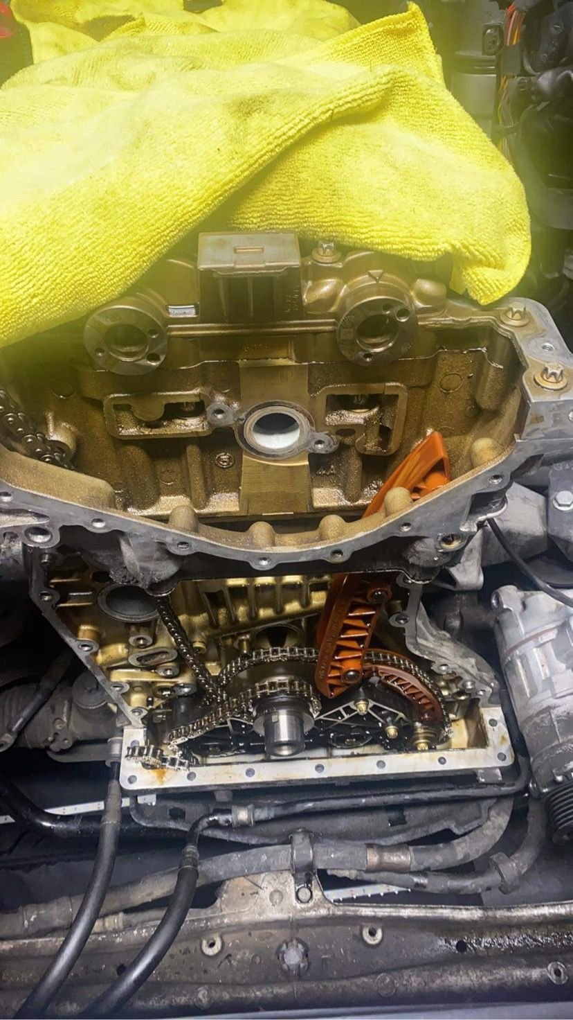

I was able to remove the timing cover without dropping the pan all. I removed all the bolts and that where on the cover and the few on the bottom holding the cover to the pan.
All accessories where removed.
Something to note is replacing the driver side chain guide is a real PITA you need to remove the head for this but it can be done "forcefully" without the head being removed. You have to remove the bottom portion first and rotate and take it off chances are you may snap the old guide which I did.
The tensioner bracket seemed to be in fine condition all though I don't know how to test the valve in it to see if it's working or not. Since I have a new bracket I am just going to replace it in addition the
sprocket seems to be good shape along with the chain. I may replace the tensioner as one of those since I am there scenarios still waiting on availability from the dealer for that part.

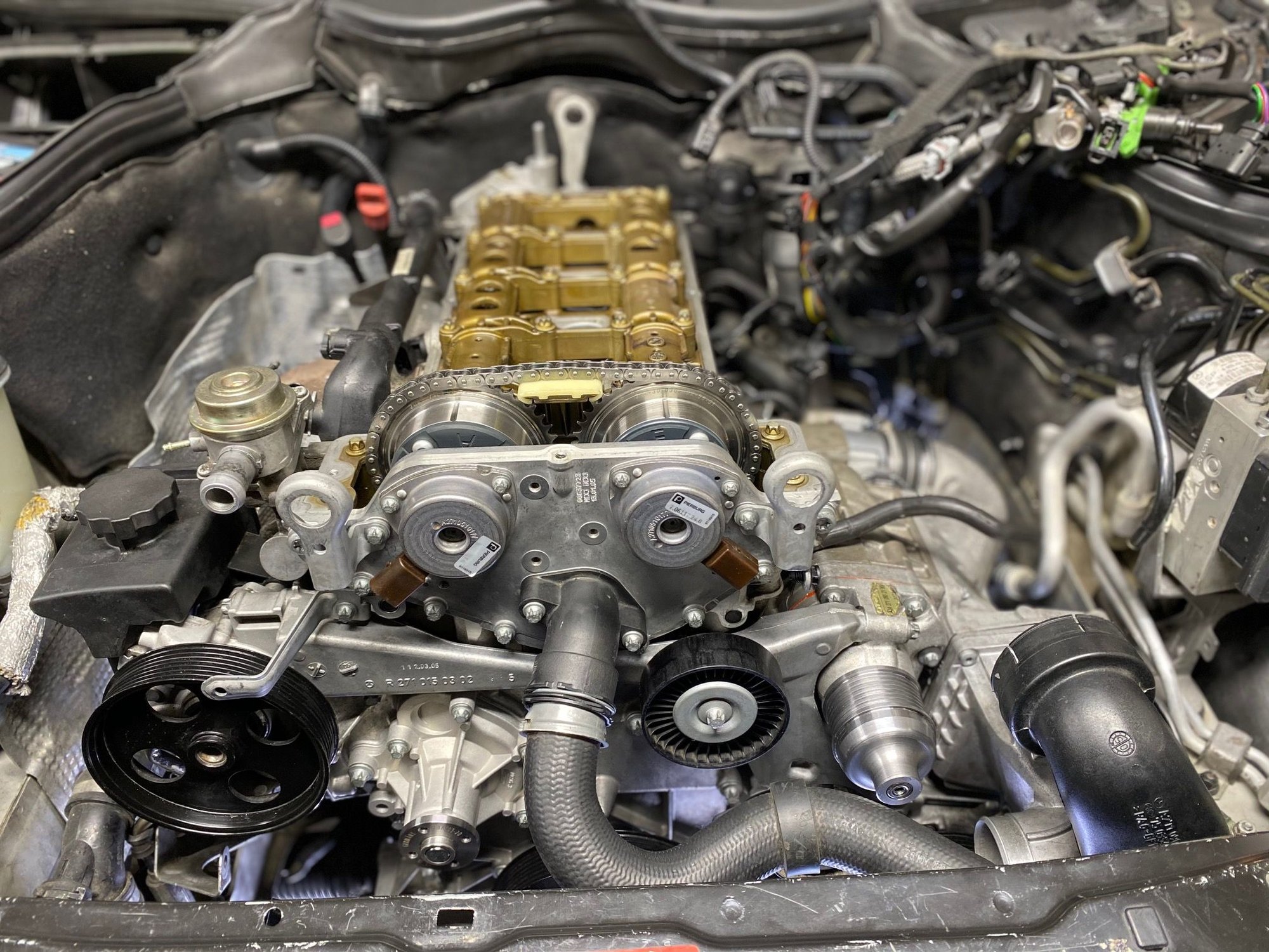

Still going at out after cleaning all the parts and covers and piecing everything back together the conclusion is this. The oil pan needs to come off in order to install the cover back it's an extremely tight fit and good thing we did because there was pieces of the sprocket in the oil pan.
While everything was off decided to swap out the supercharger pulley and oil.
My alternator has indications that it's going bad so I am waiting for that now meanwhile I am detailing the engine bay.
Here's some pics to enjoy.... here's to hoping when everything is on it's good as new...

Are there any hidden bolts? Prying on this the way i am only means I'm damaging the sealing surfaces. I've been at this for my second day and found the lower right bolt wasn't out. Unfortunately that didn't mean I got this off. My guess is the previous owner used black rtv to seal the cover, and that's about the perfect glue. One more evening and I'm lifting the cradle back, dropping the engine, and sending it to the local charity.
There are 2 bolts on top you have to remove the cam actuator/sprocket to get to the one below the driver or passenger side you can see them from up top. I am assuming you removed all accessories I don't recall how many bolts in front hold the cover the together but I did run into a situation because my cover was so filthy i missed one. There is some pry points on the over that I used on top and at the bottom. post some photos i'll see if I can help point you in the right direction.
