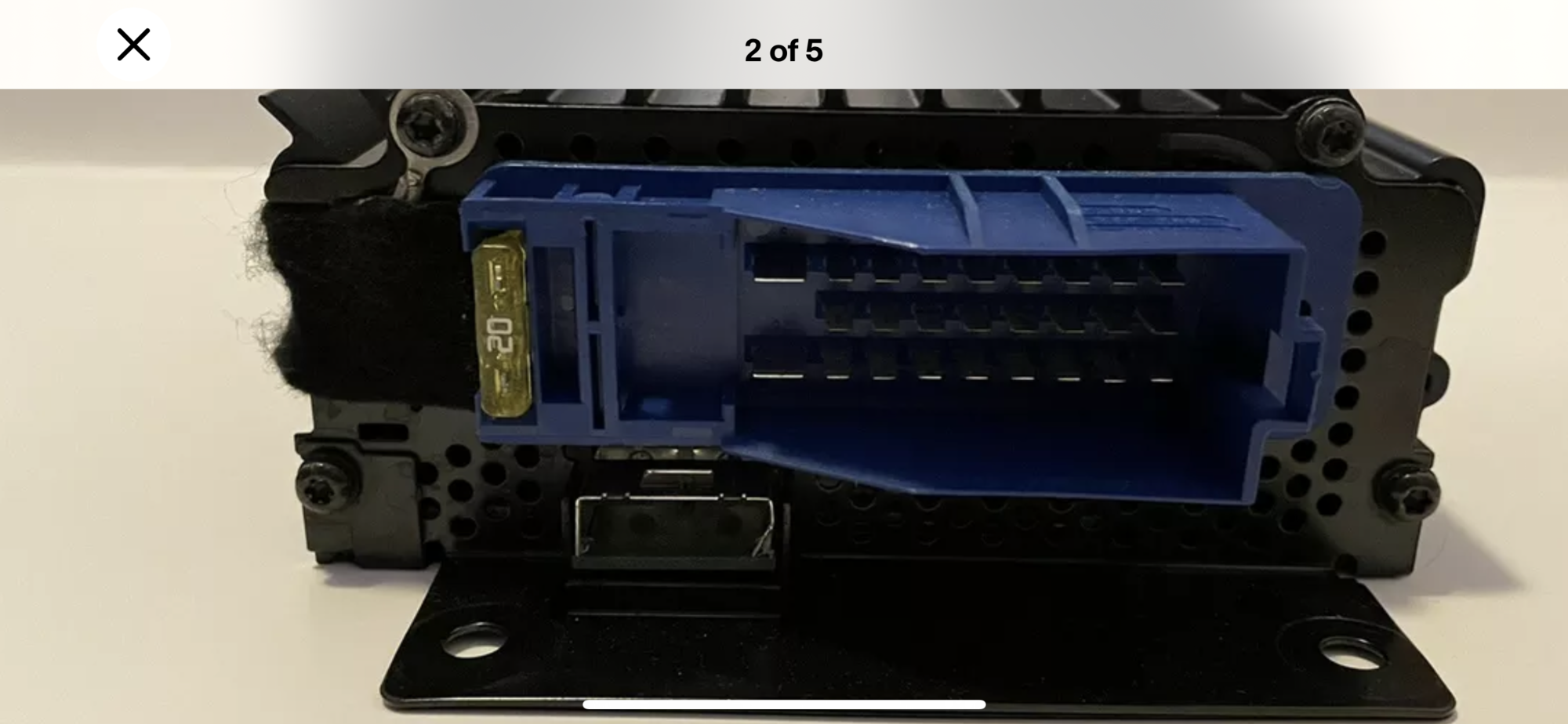

01-04 Mercedes C-class BOSE amp 2038201589 For wagon models

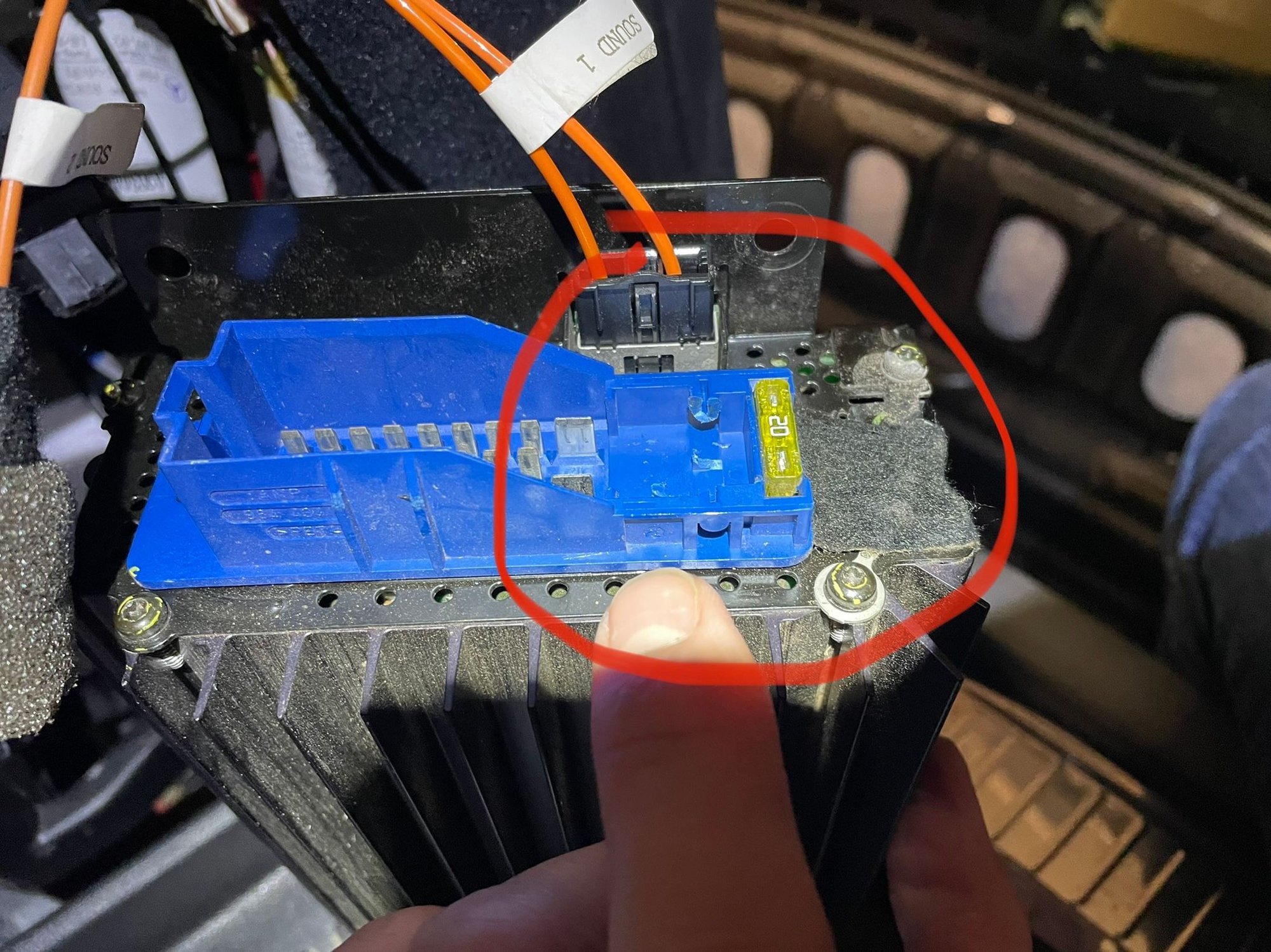

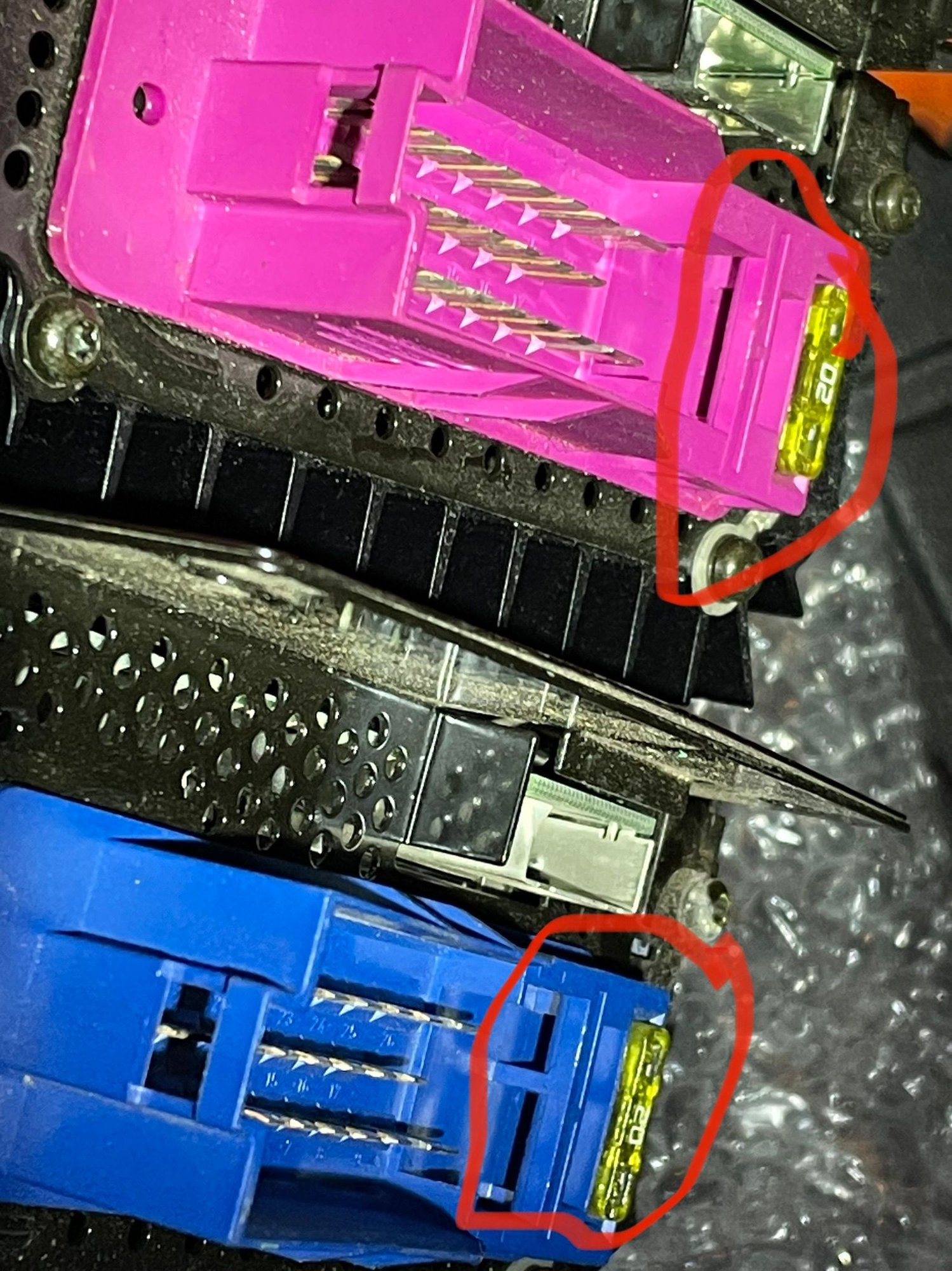

Kevin - thanks for your feedback and I wanted to report back that the BLUE amp from the C32/C240 sedan (non-wagon) does work perfectly and my radio & CD player is functioning again!
NOTE - the Amp for the sedan (blue connector) vs the wagon (pink/purple connector) are nearly identical but until I received the blue amp today I didnt realize that the connector has 1 small plactic piece in the connector that doesnt allow it to fit without minor modification to the blue amp connector and/or the connector housing attached to the car.
My photos are attached here to explain - as you see both amps are NEARLY identical but the pink/purple connector from the wagon amp has a open slot and the blue connector from the sedan amp for some reason as a blue separator in the slot which is why it wont fit into the wagon amp connector housing unless you grind down that blue separator and/or grind down the black tab on the amp connector housing wired to the wagon.
Net net - the blue amp was $80 bucks and all sound system is working again so dont waste money buying the harder to find pink connector amp for the wagon which sell for $200-300 on ebay.
sorry to not provide better photos or details but PM me if you have a S203 wagon and need help with this.
note the pink amp has an open slot while the blue amp as a divider in the slot which is what you have to grind down/remove to make the blue amp (sedan) work in the WAGON
i ground down the clip that slides into the groove in the pink amp open slot (wagon) which the blue amp slot (sedan) has a divider in and it wont fit
i ultimately decided to just remove/grind down that blue plastic divider in the sedan amp which allowed it to fit in wagon connector with the tab that was supposted to plug into the slot with no divider in the wagon pink amp

The difference in the two connectors (color and blocked slot) are probably there to "mistake proof" the assembly process. MB didn't want the workers to install the wrong version of amp in the car.
