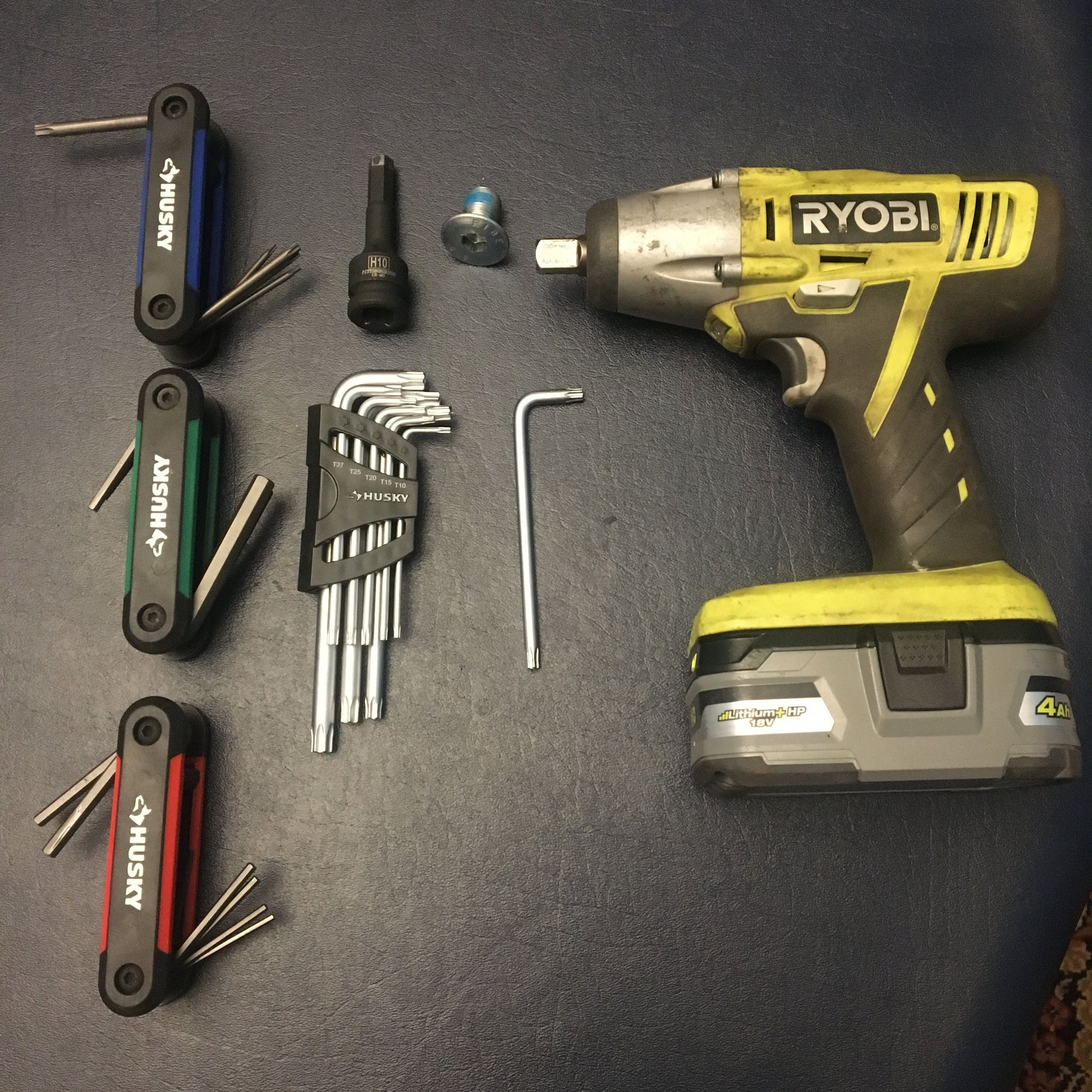

Like I said I was at the junkyard on Saturday with no intention for getting any steering wheels. However after I saw its perfect leather I knew I had to have it. That said I didn't have the proper tools to get behind there, since all my torx in my junkyard tool bag are screw driver type. I came home and did some research and discovered they make Torx Allen (Shaped like an L) type tools. So I went to Harbor Freight, but they didn't have the correct T30 size. While there I got a half inch impact H10 socket to remove the center bolt from the wheel. Then I tried home depot and got a L shape Torx tool set for around $15, and a bundle of Metric, Standard, and Torx Allen keys. I was glad I got both since I needed the handle of the multi tool to break the fastener free, and the ease of spinning the single tool. It was tedious, but I managed.
Next was removing the airbag clips. They looked like coaxial connectors for laptop wifi cards, only much larger. I used a small prybar, and they cracked right off. Oh well, I was planning on taking the clock spring as a spare, but those airbag connectors seem to be unremovable from the clock-spring. I think the orange retainer clip must be removed or at least pulled out before removing the airbag clip. Usually I am much more careful, but it was cold and windy, and even a bit of snow. So by this point my hands and the plastic was cold and brittle.
Anyway, next was to insert the H10 tool into the center steering bolt fastener. Luckily I didn't rely on only an Allen key this time. I attached it to my half inch impact driver. Mind you this is the same driver I used to pull off the wheel lugs the day before, it even has an uprated battery. I kid you not, it took at least 30 seconds continuous hammering at this bolt! I was truly impressed with how tight that bolt was! Once I got it off, my next worry was not having a steering wheel puller, but that faded when a slight jolt was able to pull the wheel from its home.

Here are the tools I needed to remove the steering wheel. The Torx with the handle was good for breaking the screw loose, and the thin single T30 was good for removing it, though it was a bit long. The H10 from harbor freight did the job but put a bit of swelling in the large bolt around the edge of the hex.
