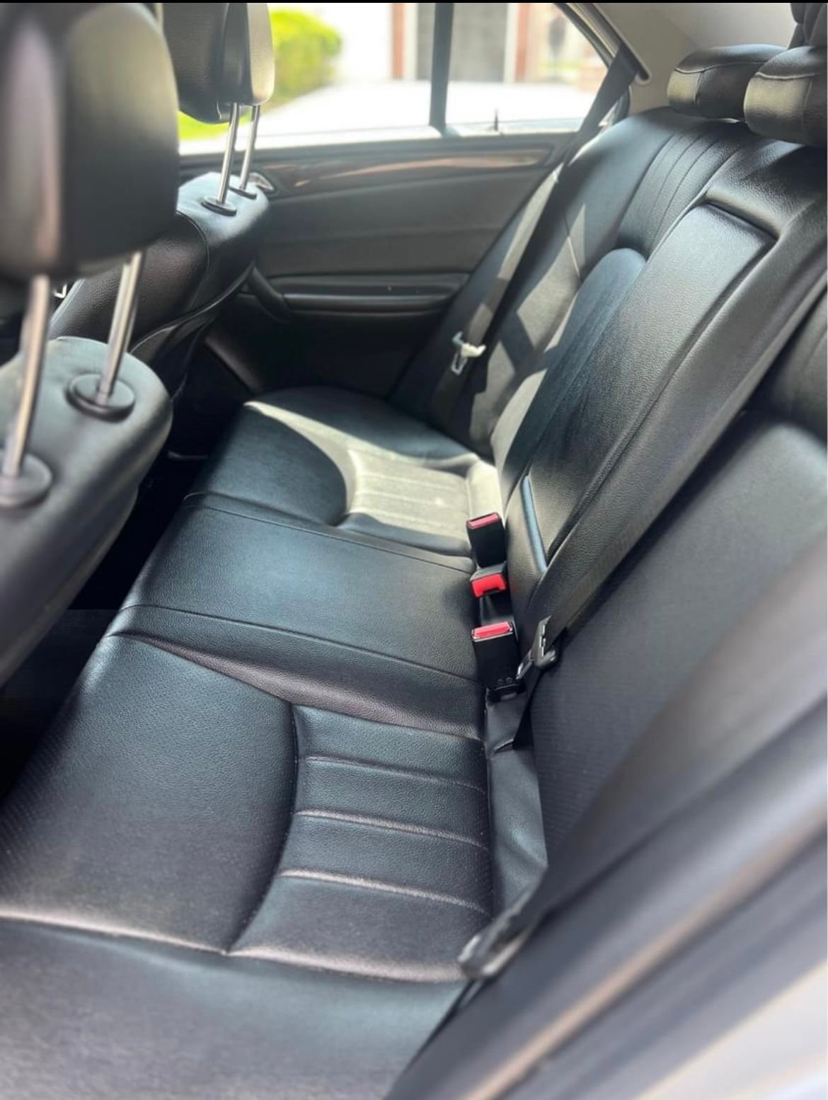

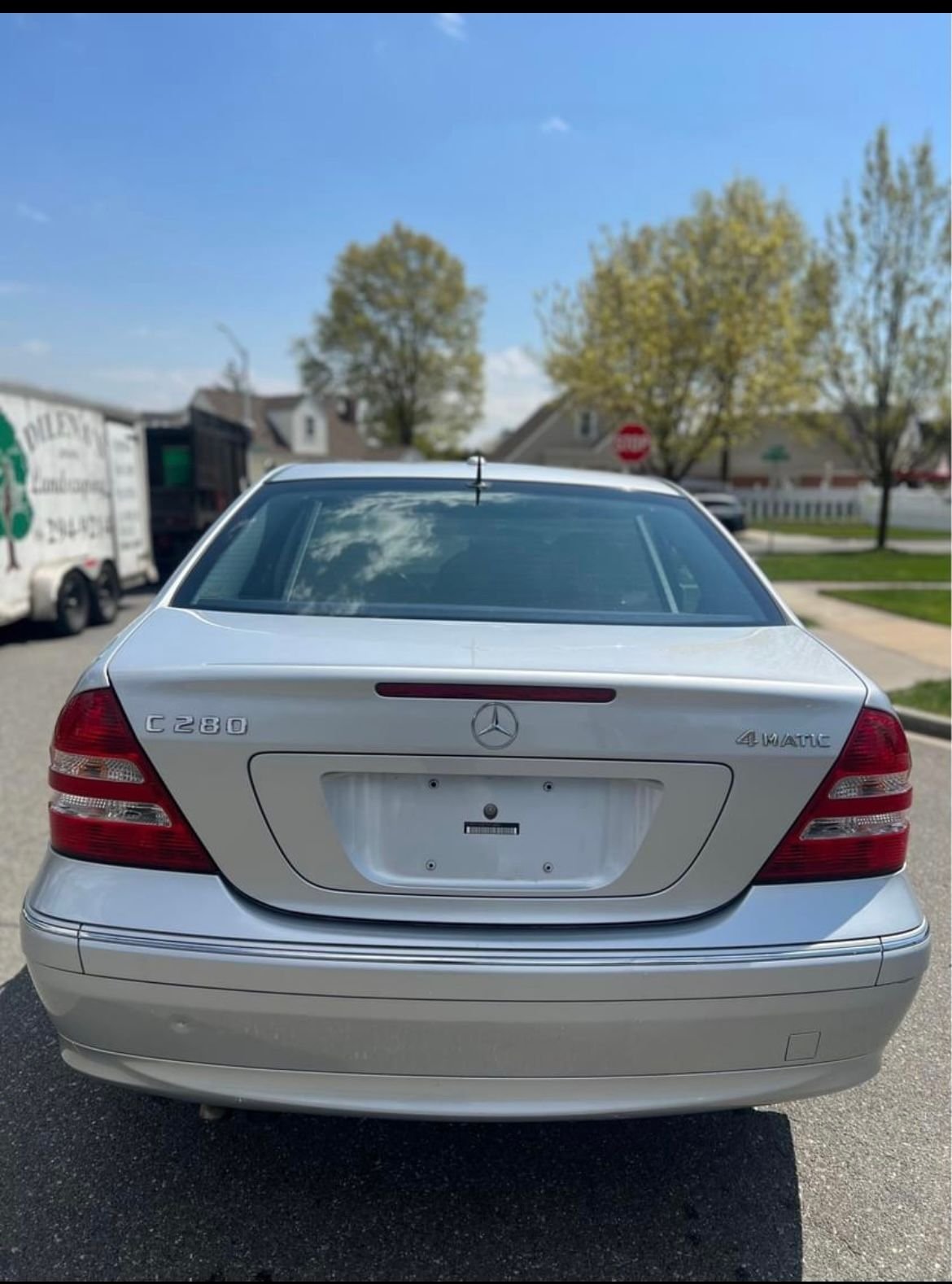

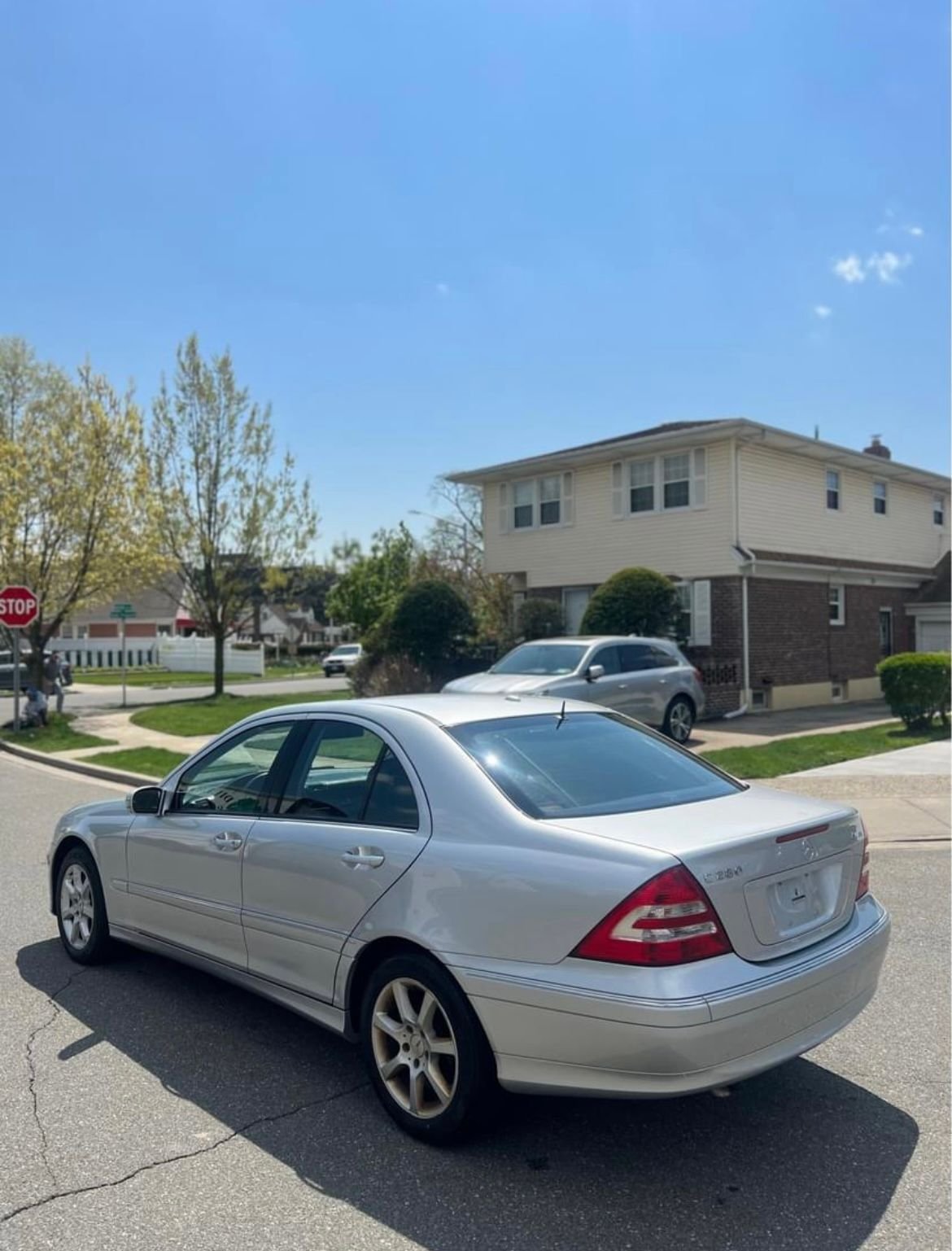

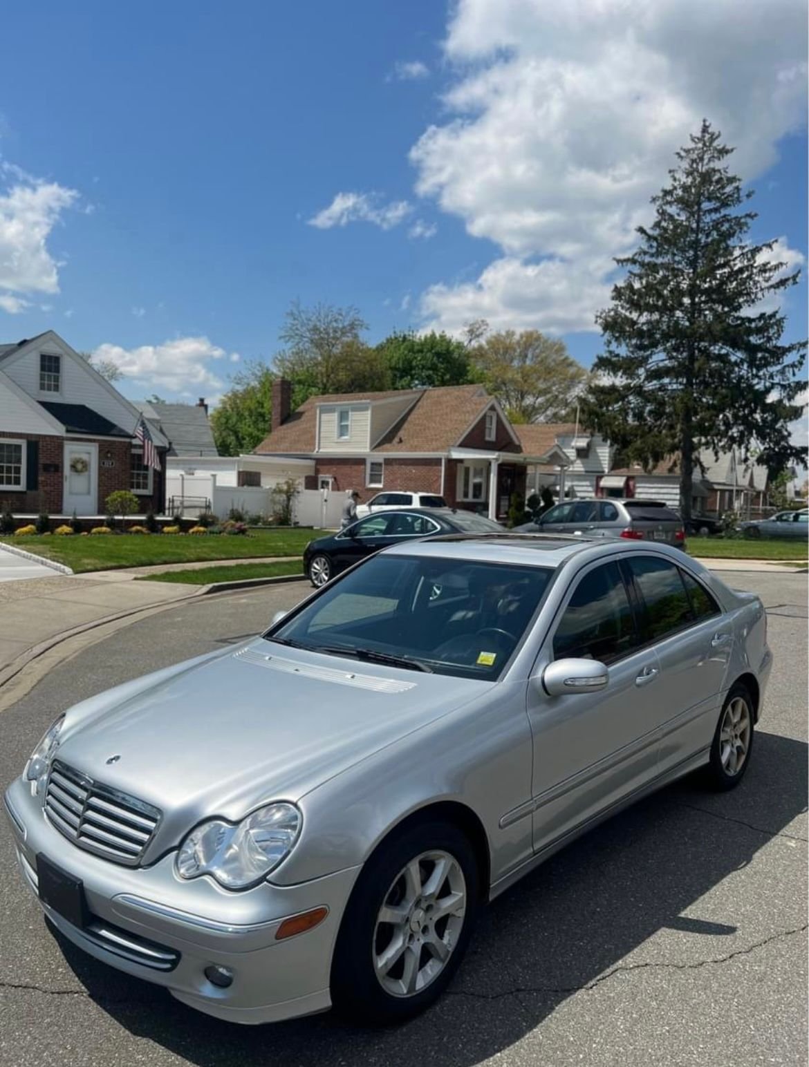

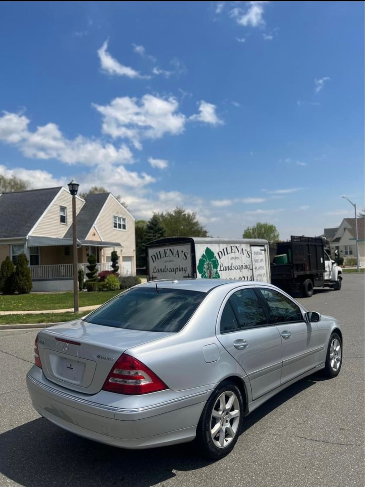

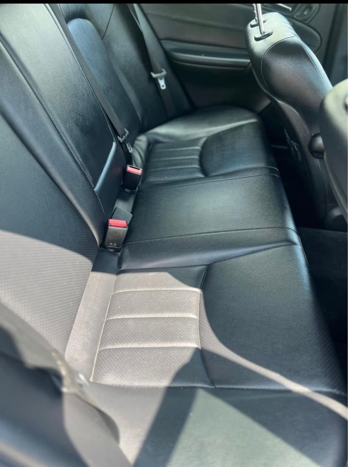

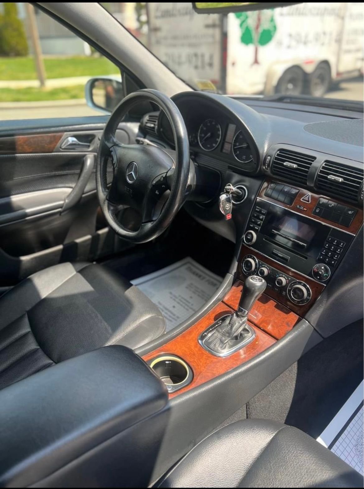

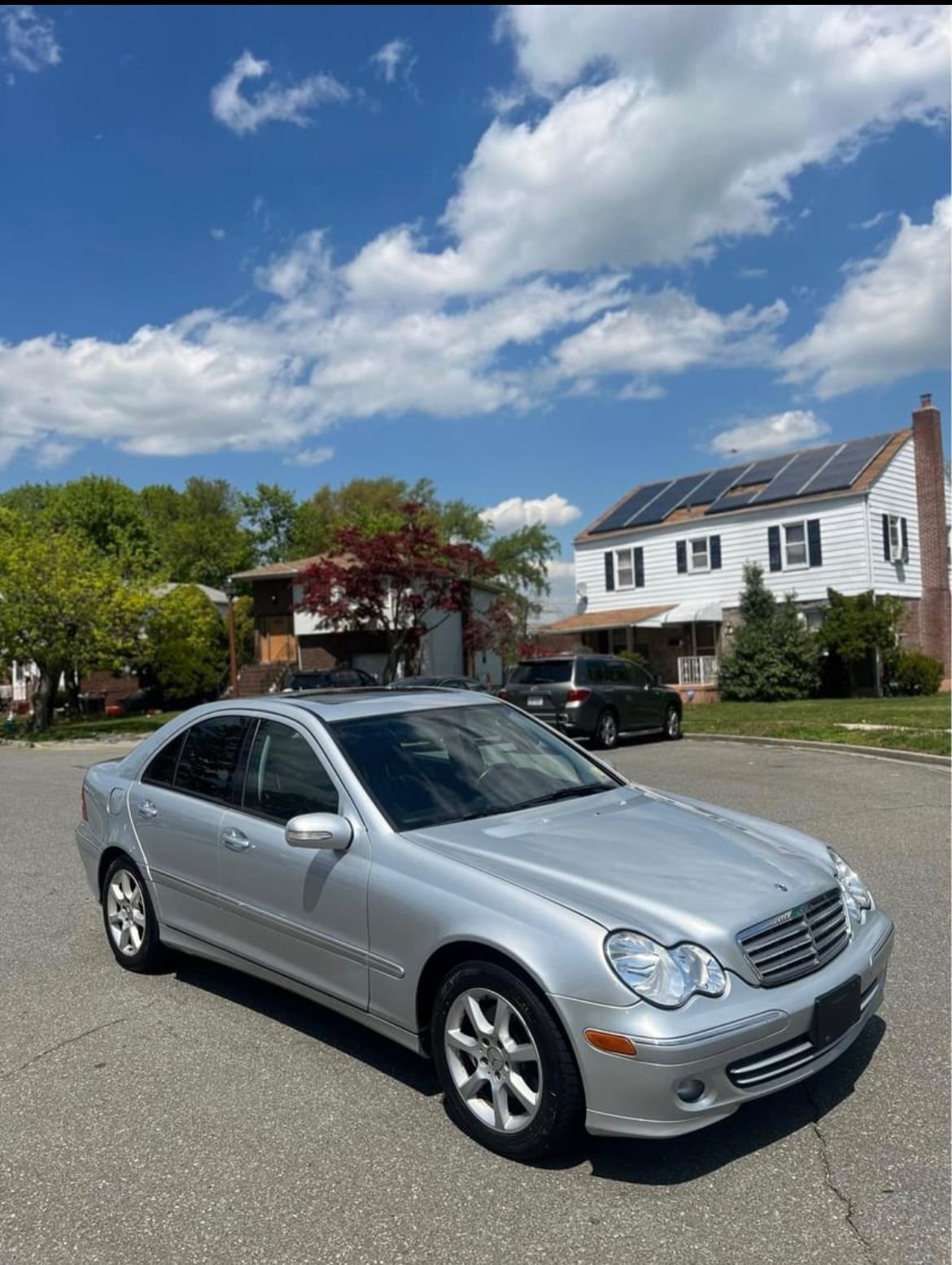

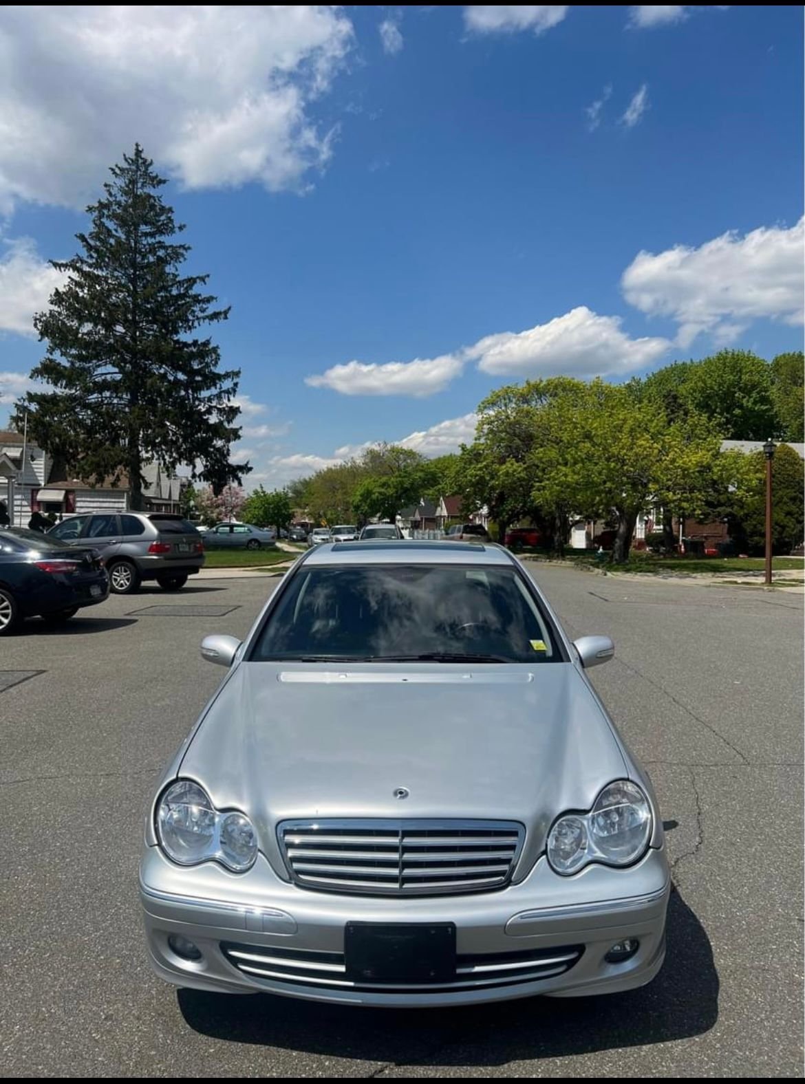

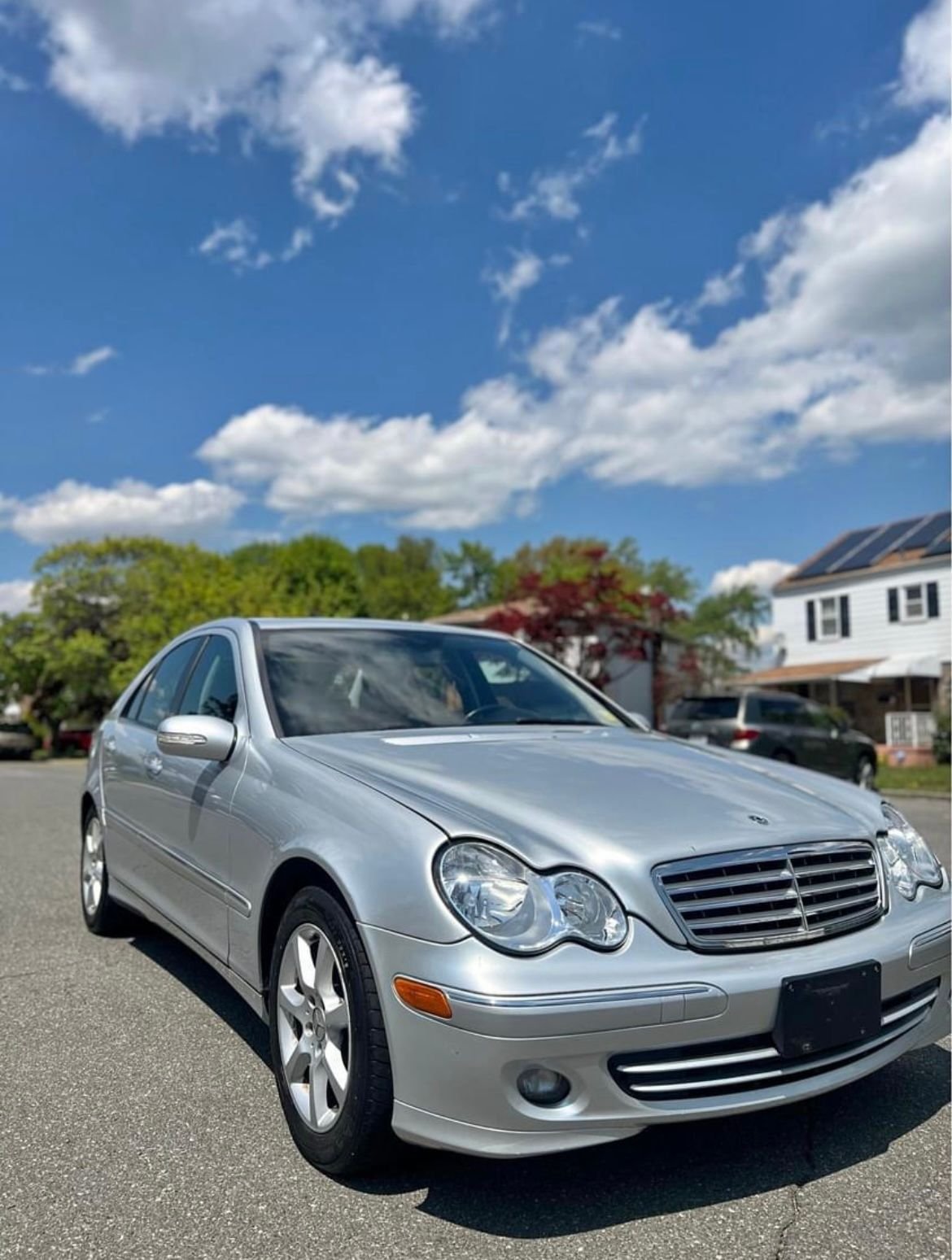

Post pics. I had a 2005 C240 4M. Very reliable car. Interior was junk but it never broke down or left me stranded. Drove it 300,000 miles!
Old May 13, 2023 | 11:43 AM
clb0099's Avatar
Joined: Jun 2012
Posts: 893
Likes: 242
From: New Jersey
‘16 Mercedes GLE450 amg,’15 Mercedes gla, coupe,’07 Mercedes w221,’12 Audi A
Hello,
Alittle background on the c-class. I knew it had prior accidents from what I can tell from the carfax report. It currently has 109k miles and the interior is mint. Like I am shocked how clean it is for a 2007. As my son is going to college pretty local and is not thinking of staying at school. Needless to say I have been a Mercedes cars owner for over 20 years so I tend to stick to Mercedes. When I first bought the c-class I knew it would need some mechanical stuff as no car that’s usually nearly 17 years old doesn’t. Off the bat it needs tires, rotors/pads all the way around, transmission flush, and the wheels need to be refinished as they have seen better days. The exterior of the car is also very clean and no visible damage. Of course I had to replace the hood release latch cause it was broken but it was an easy fix. Lastly the air conditioner blows hot air. I ordered a new compressor kit with condenser, compressor, and O-rings. I paid 3k for the car so if I put another $1,500 into it with parts and labor then I am happy. So far in parts I spent about $700 my friend who is a wholesaler has a mechanic shop on site.The mechanic quoted me $400 in labor to do brakes, install ac compressor and refill refrigerant, and transmission service. As far as cosmetic things I already did to the car was installed white led interior bulbs canbus error free also installed the bulbs in the license plate lights.Installed hid low beam kit. Ordered new floor mats. The last two things I changed was the hood emblem to the flat hood emblem and lastly ordered android carplay radio with rear view camera.
QUOTE=C280 Sport;8776763]Post pics. I had a 2005 C240 4M. Very reliable car. Interior was junk but it never broke down or left me stranded. Drove it 300,000 miles![/QUOTE]
