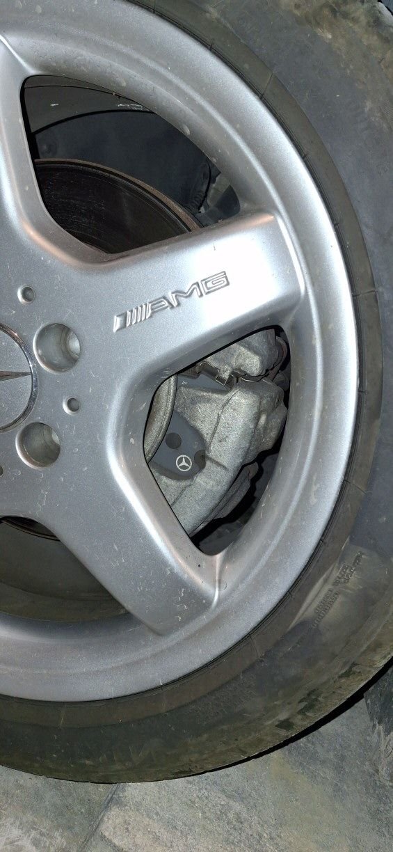

You mean on the sill, or "doorstep"? It says "Mercedes-Benz" (not "AMG").
I've taken a photo of the first brake caliper, although I assume if it'd have been helpful, somebody would have told me by now

Your caliper is the normal 1 piston type.
Does that mean a 15" or 16" wheel will fit?
