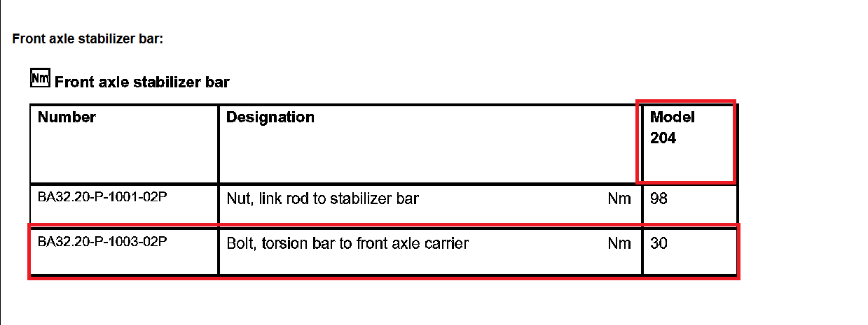

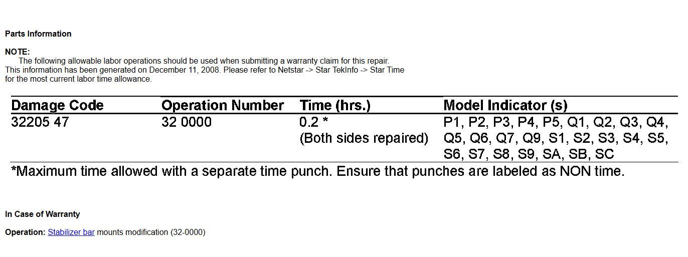

I have the W204 and I know the 4matic front sway bar is bolted into the front subframe and the RWD uses nuts and bolts.

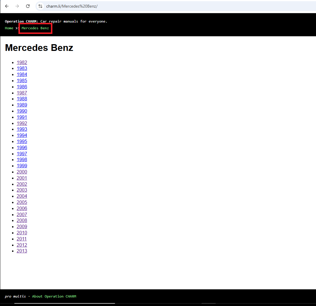

Im not sure about the W203 so looked it up in the manual. I came across a bulletin that may be useful. Heres the online manual i looked thru, under Steering and Suspension > Suspension > Stabilizer bar. https://charm.li/Mercedes%20Benz/200...d%20Diagnosis/

Wow, thaanks so much for looking that up, and also for turning me me on to such an amazing rescource!
I'd never heard of this before! Where and how did you ever find it?
Anyway, that was the one missing piece I needed to at least replace the swaay bushnigs and sway end links.
We'll see how it is after that in combiination with new steering rack bushings.

I just stumbled upon that website while searching around online looking for repair procedures for my W204. That site has the repair manuals for 1982-2013. the later years 2012-2013 do not seem complete but for my 2010 W204 it has pretty much everything to take the car apart.
From the link click on the year and see if yours is listed. They have a few 2006 models. https://charm.li/Mercedes%20Benz/
I cannot seem to find the torque specs for the sway bar bolts for W203. I looked for similar years and models to get an idea what it may be. Can always roughly follow other specs, im guessing 20-40nm to be safe.

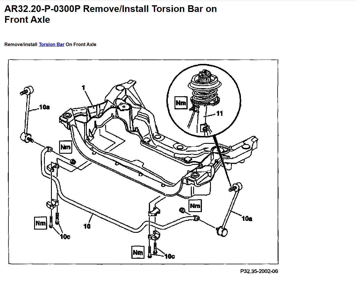

If I'm reading this correctly
the end link to torsion bar on AMG end link with M12 mm nut is
100 nm vs only 55 on the standard M10 version? That's quite bit more!
They were certainly on tight on the
way out (10mm) I had to use a pipe
on a rachet, wasn't room for
a breaker bar.
Upgrading to AMG end links.
Also replacing lower control arms.
Had to quit, need a 21 mm
open end wrench, hit up Napa in the AM.

BTW I did what that service bulletin said and installed a helicoil. Seems to be working good.

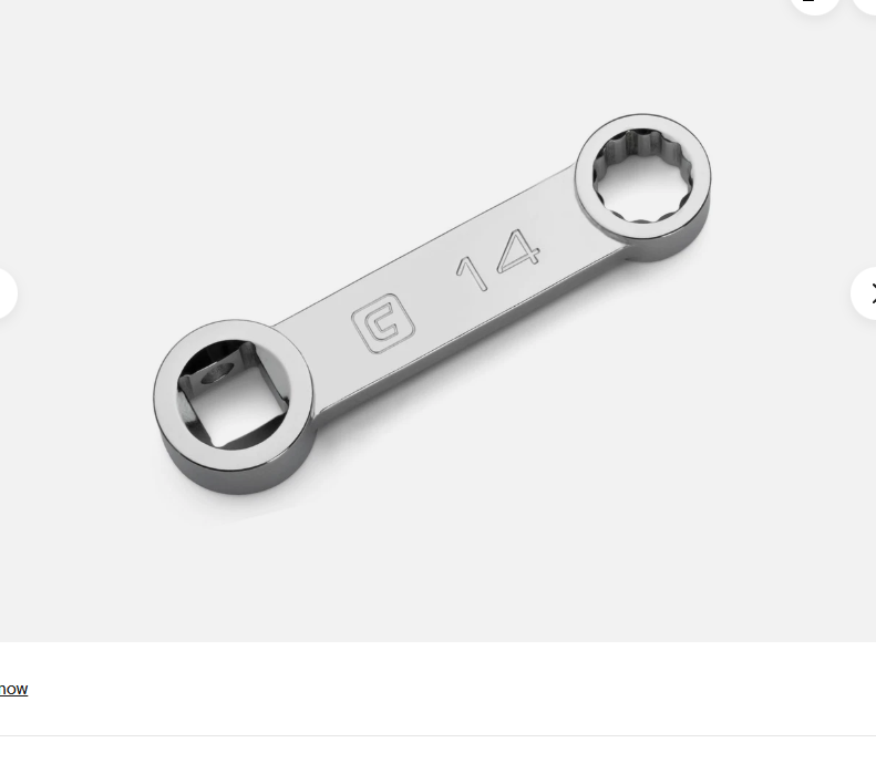

Those torque extenders aren't so easy to find locally.
I'm putting together a chart for all the torque values in the front suspension.
Lower control arm to chassis needs 150nm = 110 ft lbs. Dang!
Upper is 120nm+90 degree.
I doubt I was able to get to those levels with my open end wrench.
And I also kind of doubt that these chinese 12 point extenders can handle either
