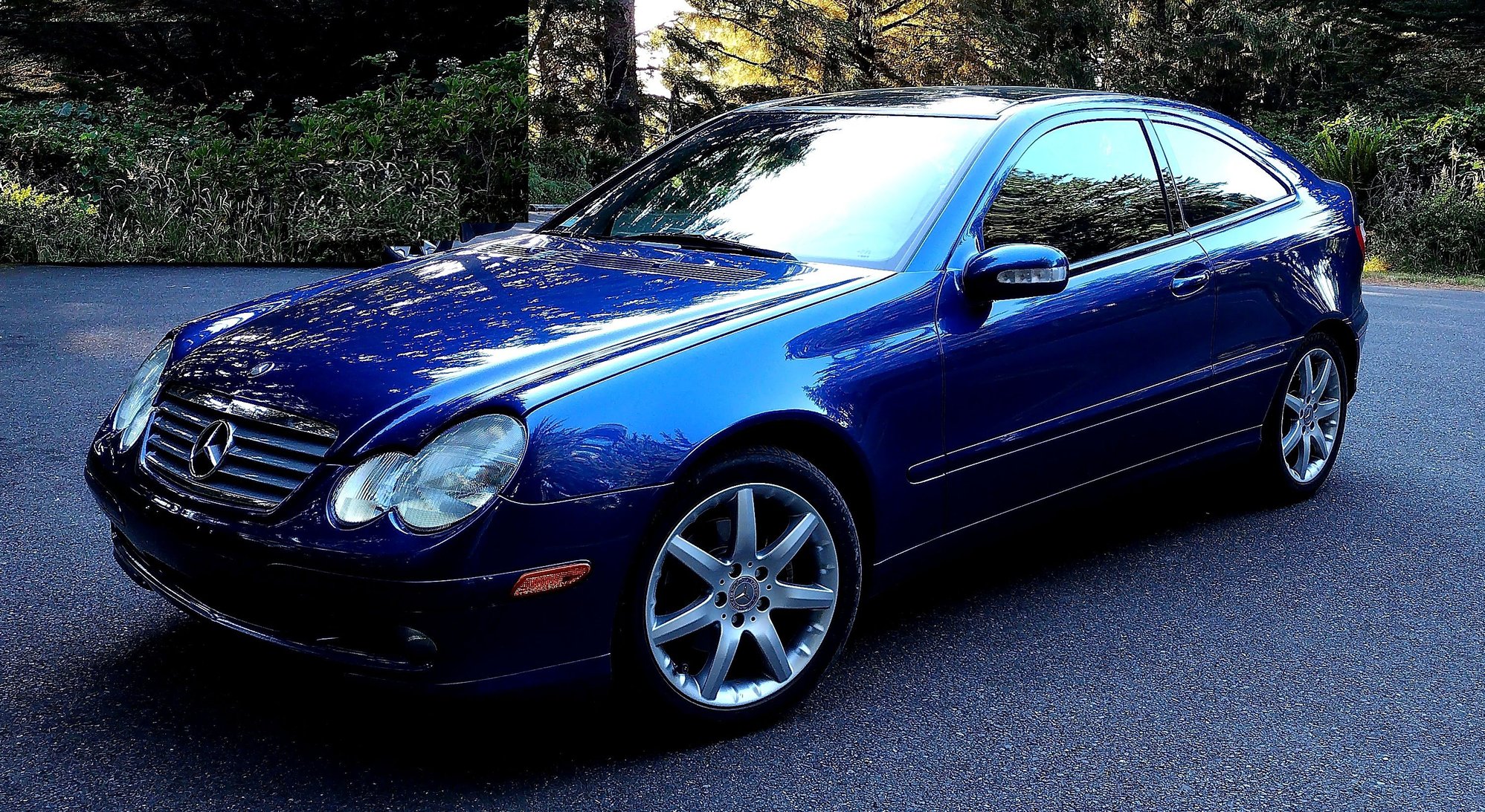

It's been sitting for 2 weeks on jacks since I got it home, but every time I walk in the garage, wow.
My crappy phone cam doesn't do it justice. The paint is such a deep blue, I remember that from when I picked my
original 02 up at the dealer in Feb 2002 right after the pealed off the white plastic that is put in for shipment across the ocean.
It's been a long time since the paint looked so good. Ohhhh baby!
The car is litterally like new. All the rubber weatherstripping, and little details are just as they rolled off the
production line 23 years ago. Nary a single scratch or dent. Freakin' beautiful. The dealer aside from detailing it and making it

So here's a more recent pic of "Inga" before the clear sides. A good German/Swedish name for a sexy car.
