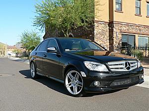

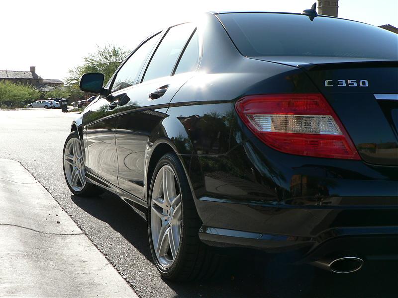

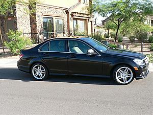

Here are some pics of mine with the chrome strips removed (and after a Zano Brothers detail)!
Attached Thumbnails Anybody strip the chrome along the doors?-p1010883.jpg   Anybody strip the chrome along the doors?-p1010878_edit.jpg   Anybody strip the chrome along the doors?-p1010889.jpg
