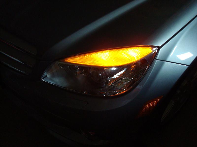

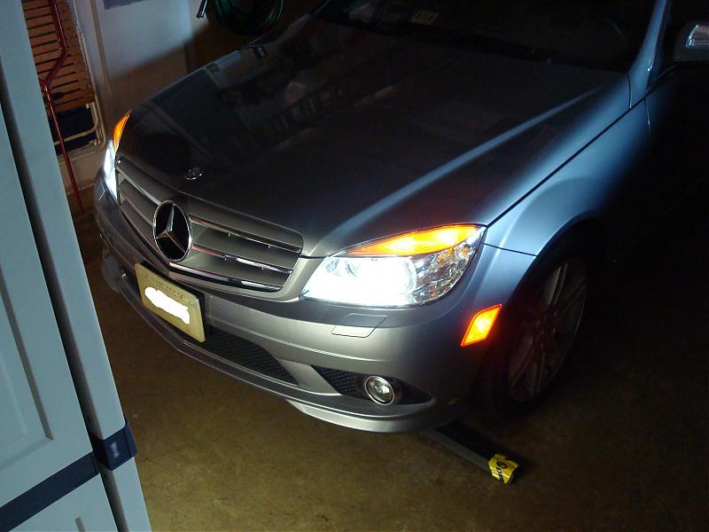

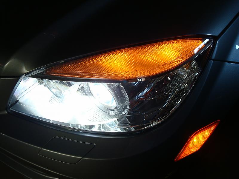

Orange Eye Lids
Here are couple of pictures.
Attached Thumbnails Anyone have DIY to exchange bulb?-dsc01681.jpg   Anyone have DIY to exchange bulb?-dsc01682.jpg   Anyone have DIY to exchange bulb?-dsc01683.jpg
Old Jul 26, 2008 | 01:40 PM
Azn_C300's Avatar
Joined: Apr 2008
Posts: 3,809
From: Chino Hills, CA
Mercedes C300 Sport, BMW 745Li, VW Mk6 Golf TDI
That's interesting. Not my style as I'm trying to remove the amber, but good idea nonetheless.
Old Jul 26, 2008 | 01:59 PM
Flame3g's Avatar
Joined: Mar 2008
Posts: 1,423
From: Hampton, GA
CLK500 SPORT
looks wierd with the orange
