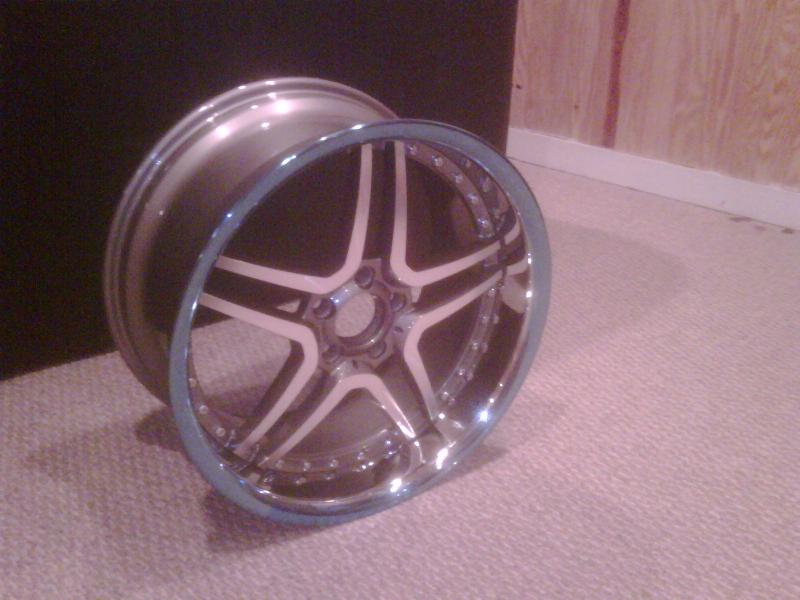

i just got these rims but im having a hard time trying to decide wat tire size will go well on my car....i have 19"in 8.5 in the front and 9.5 for the rear......my question is wat is the best tire size?

woo hoo! Euro63RS! one of my fav wheels! congrats! go Falken!

but size thooo ?? for the front got this 235/35-19 and for the rear 255/30-19 but i dont really wanna bad ride i still want a kinda stock ride....but i need help

The size of rims that you've gone with can never give you a ride comparable to stock! You need to compromise on that as the sidewall size of the tire has been cut down to 30 as compared to the stock sidewall size of 45/50 depending upon the size of your stock rims. I hope this helps

i was wonderin if i could but on 235 / 40 19 in the front and 255/35 19 in the rear without rubbing

Good luck with that...
Just to compare, I'm using the OEM size off mine:
225 45 17 = 24.97"
235 40 19 = 26.40"
increase: 1.47" height
increase: 10mm width
decrease: profile
245 40 17 = 24.72"
255 35 19 = 26.03"
increase: 1.31" height
decrease: profile

255 on a 9.5" rims sounds too narrow. 275 in rear no???

For the rears you might need to go a little further like 265/35 as the the rim width you will be using is 9.5". Personally, i would go in for an 18" diameter because driving with 19" on Indian roads is a torture. Having said that, i would like to tell that my tire configuration is going to be the same as 235/40/R18x8 for the front and 265/35/R18x9 for the rear. You might also want to try 275/35 for the rear but i think that would rub the inside of the fender. For such wide tread widths you either need to increase the arc width of the fender or add spacers! The latter is NOT RECOMMENDED!

I have the wheels in 235/35/19 for fronts and 265/30/19 in the back. The tires are Vredestein Ultrac Sessantas and it will cut very close to rubbing in the rears if I installed SuperSports. Not entirely sure about the other springs that are not as aggressive. I've seen a few others running 255/35's in the rear and it might help even if it is a bit taller because they will be stretched.

i have 235/30/r19 and 255/30/r19 with no rub but with full load i rub
