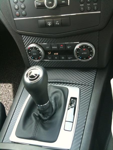

there is a clip on the side window cover,i just did mine with CF vinyl attached with the pic alo will take the door trim pic

you can use flat screw driver to undo the clips ,i m from Malaysia also attached picture for my door panel picture after done cf vinyl
