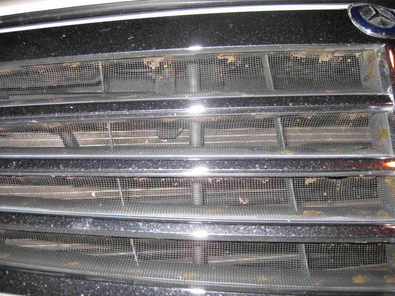

This will not impress the concours or gold tooth brigade .Please see attachment.
I cut strips of fly wire to size & glued them into place in the grill in front of the condenser.
Only very small insects & dirt now enter & flow through both condenser. intercooler ( diesel) & radiator.
One of the greatest causes of engine failure is through overheating .
