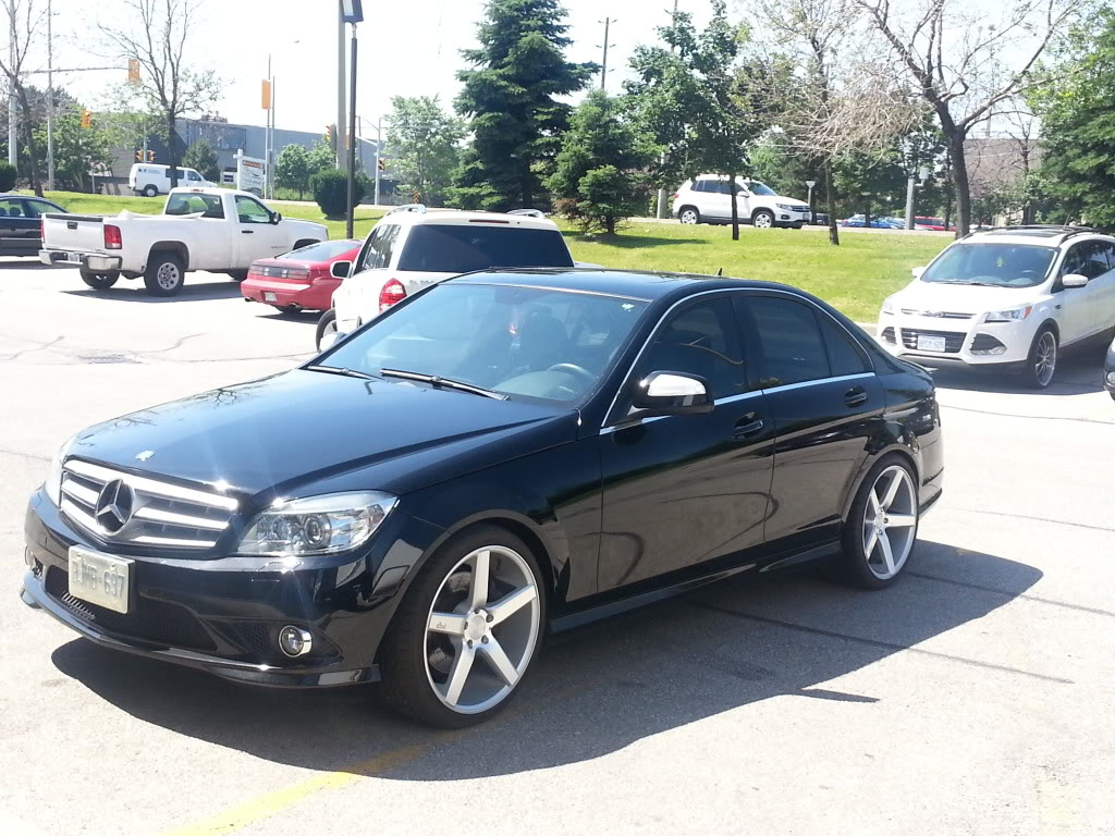

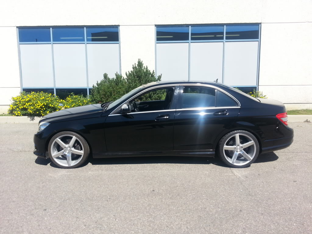

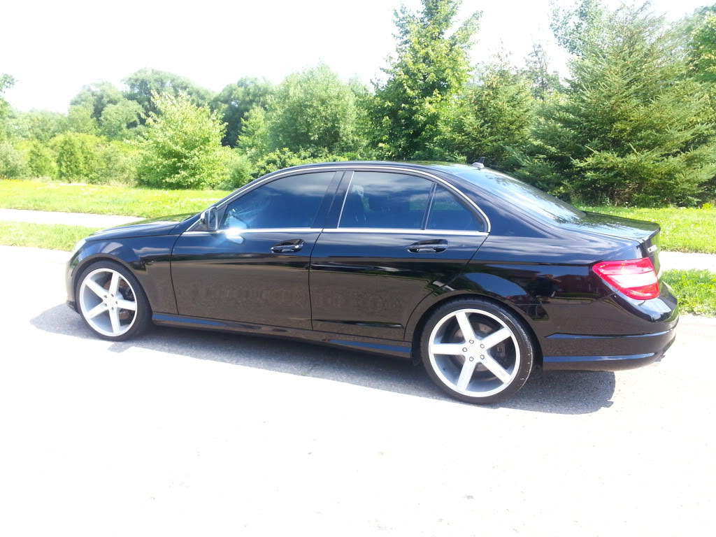

Old Jun 23, 2013 | 08:04 PM
  #856
popp's Avatar
Joined: Aug 2011
Posts: 140
From: Calgary, AB, Canada
'09 C350 4M, '11 Sienna SE, '84 VW Jetta GLi

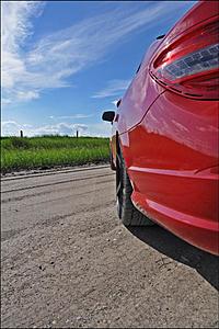

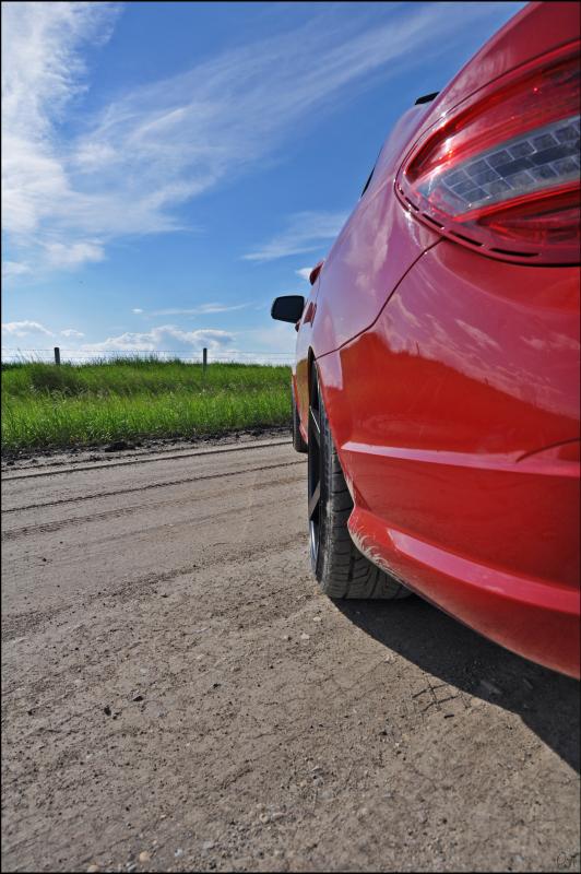

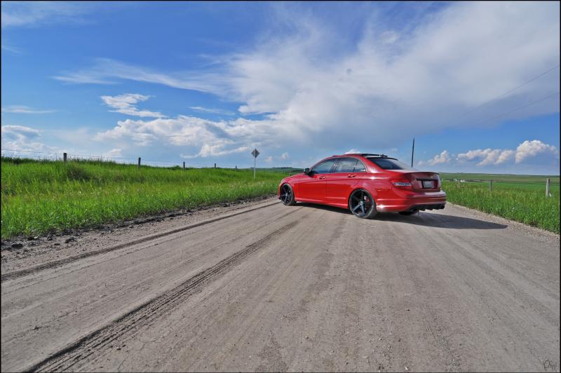

Rohana RC22
20x9 et45 with 225/35r20. No rubbing. 4matic, Lowered on H&R Sport springs with 5mm rear bushing.

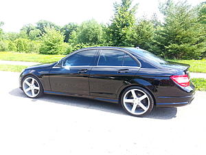

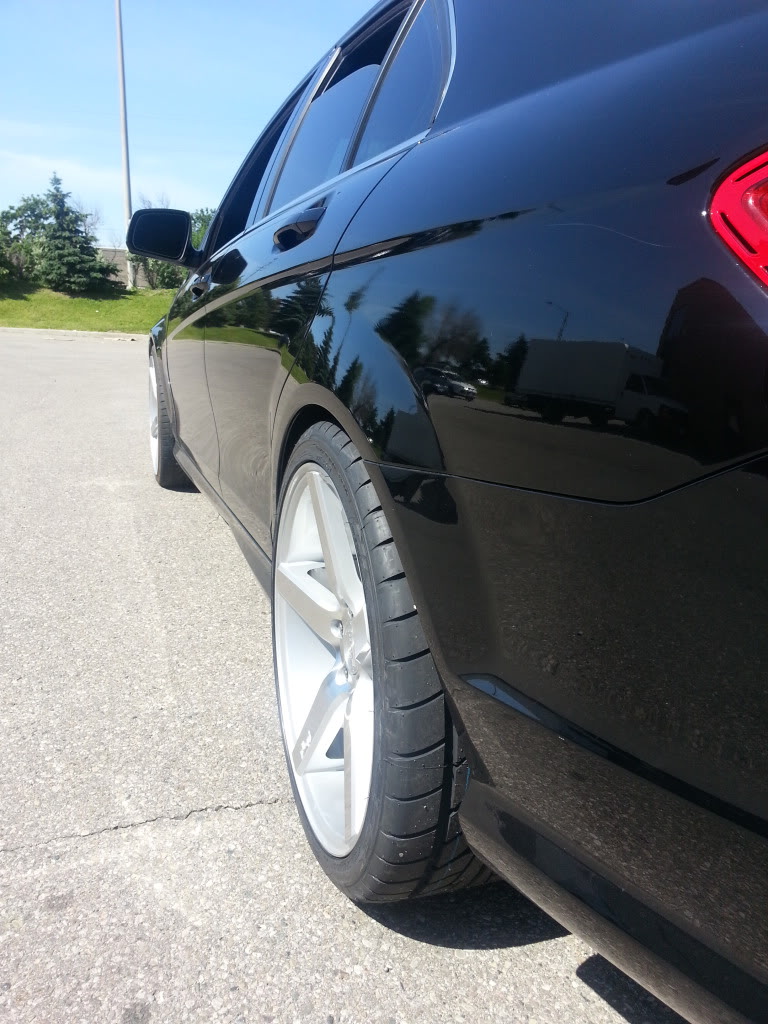

19" Niche Milan Wheels. 19x8.5 front 19x9.5 rear. Tires are 235/35/19 f 275/30/19 r. 48mm offset all around. fenders rolled.
I have to be really loaded to rub.

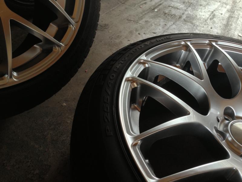

i have a 2010 c300 4matic, bought 19's avant garde 255/40r19 wheels 9.5
what tire size do i need so it will not rub, would 245/30r19 be ok
