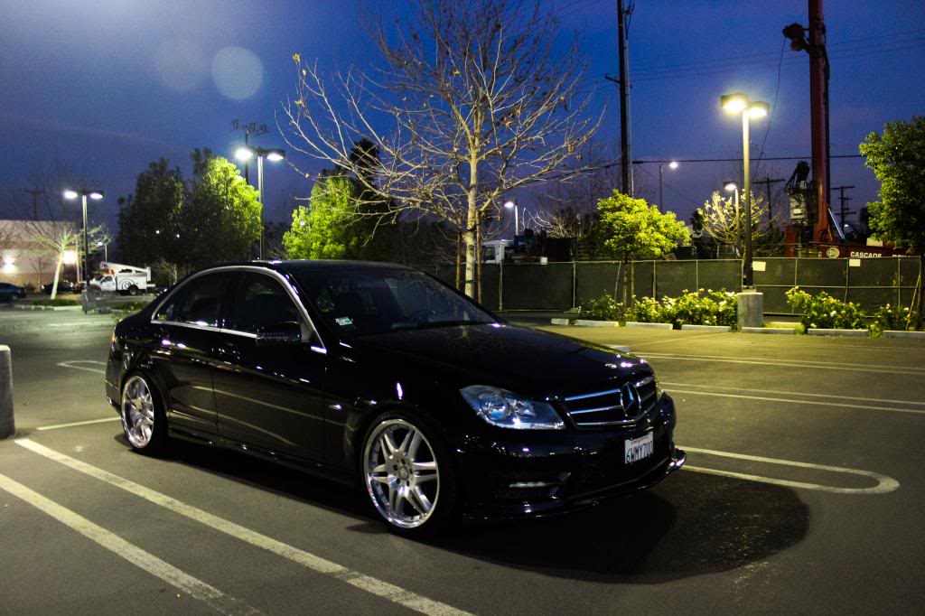

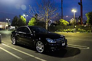

Love my new set up
Brabus VI
19x8.5 et:33 225/35/19
19x10 et:42 255/30/19
Lowered on H&R Super Sport Springs with 5mm pads in the rear

You sir have helped me make my final decision. Before I order, do you rub and do you have the fenders rolled?

Yeah I used to rub but i cut the inner lining of the rear fender and shaved where the bumber and fender meet a bit and had pulled them a little, also im running -1.9 camber which helped stop the rubbing

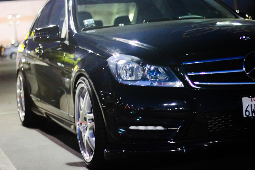

Pictures of my new shoes
18x8.5 et 44 all around on michelin pilot MXM4 235/40 at front 255/35 at rear
Nice
Do you run on stock springs?

Thanks snickaren! stock springs only but car is a 4matic. 1/16 gas on tank so it will drop a tad little on the rear when filled with gas.
