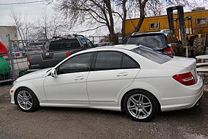

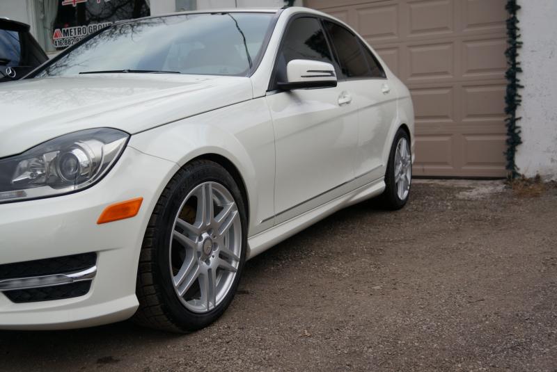

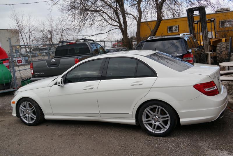

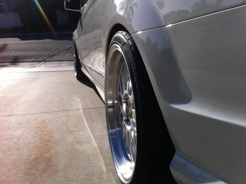

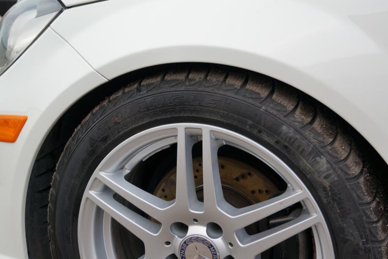

Originally Posted by Teddy Ouyang
Hello guys, I'm driving a Canadian 2012 C250 4matic with sport package. I want to buy a set of rims and tires: 225/45/17 et 35 17x8 for my winter setup. It's a good deal if it will work with my car so I don't want to miss it. Any inputs will be appreciated. Thanks!
I bought the tires and rims (17x8 +35) one season old for altogether $550 CAD and they fit quite well. They do stick out a bit more than the OEM 17inch but still acceptable. I used original nuts as the new rims are also ball sitting.
Attached Thumbnails W204's and offsets of wheels-dsc00903.jpg   W204's and offsets of wheels-dsc00898.jpg   W204's and offsets of wheels-dsc00896.jpg   W204's and offsets of wheels-dsc00894.jpg
Good timing on the post for me, your wheels look great. The fronts sit 18mm and the rears sit 17mm farther out than stock. Any rubbing or regrets on the set up?

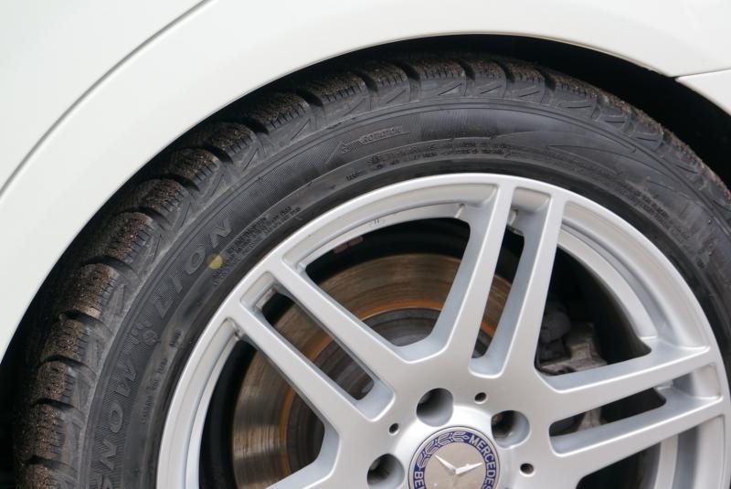

There's no rubbing at all as you can see from the photos (front and rear) and I'm running these rims with sport suspension (not sure how much it differs from the original one).
Attached Thumbnails W204's and offsets of wheels-dsc00906.jpg   W204's and offsets of wheels-dsc00904.jpg

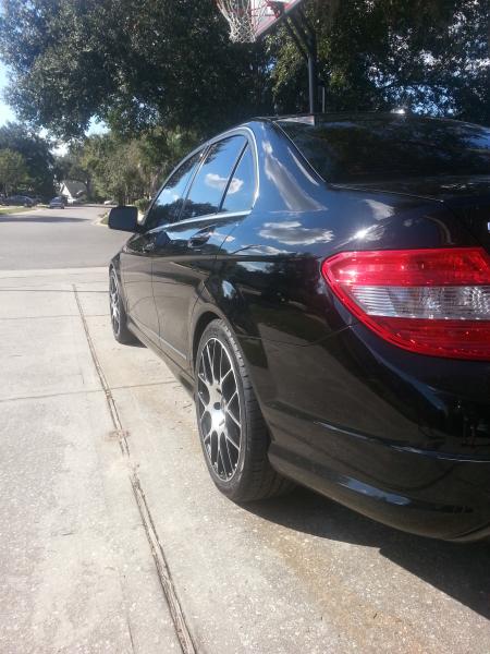

New Wheels and Tires
I was finally able to get my new wheels and tires installed Friday. I went with Niche M108 in 18X8 all the way around with a 40 offset. I wrapped them in Hankook S1 Noble2 tires. So far the ride is much smoother than the previous 17 inch set up.
Attached Thumbnails W204's and offsets of wheels-2013-12-07-13.40.08.jpg   W204's and offsets of wheels-2013-12-07-13.40.56.jpg
I like it!
Where'd you get your lip? And what size tires are you using?

Originally Posted by Richard2011
I like it!
I got it from JB Speed here on the forum and the tires are 234/40/18s.
