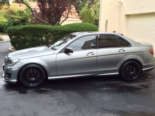

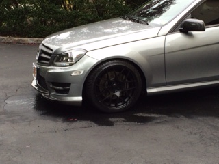

Hey all, looking at getting a slight spacer for my rears. They're 19x9.5 +52 (Niche Targa) with 255/30. It's a 08 C350 sport sedan. I'm thinking maybe a 5mm or 10mm but I think a 10 is pushing it. Any specific brands I should look at or certain types of spacers? Kind of a noob to spacers. Thanks!
Old Oct 20, 2014 | 05:34 PM
  #1166
04boxster's Avatar
Joined: Dec 2013
Posts: 126
2014 C250, 2015 C63S E1
You'll be fine with a 10mm with that setup. http://www.hrsprings.com/products/trak/

I went very conservative with offset and width and I got the perfect fitment I wanted.
Attached Thumbnails W204's and offsets of wheels-img_0841-1-.jpg   W204's and offsets of wheels-img_0834.jpg   W204's and offsets of wheels-img_0832.jpg
